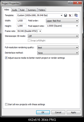

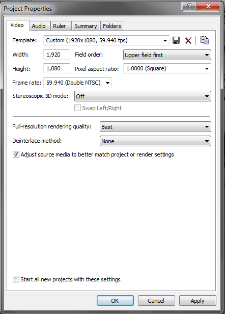

    Your project settings should look something like this in Vegas.

  7. You might be right, 60p export might not be possible in Vegas Studio, I vaguely remember to make it work with DebugMode Frame server though, but that is advanced a bit. I perhaps was able to set project to 59.940 manually, typing it in project properties window. And dmfs is exporting project properties.

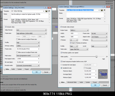

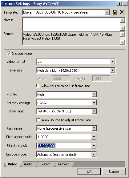

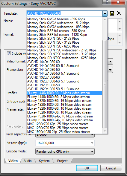

  8. Here's a couple of output options from Studio 11. mp4 is restricted to 26Mbs.

  9. QUOTE=smrpix;2290995]Here's a couple of output options from Studio 11. mp4 is restricted to 26Mbs.
    [Attachment 22371 - Click to enlarge]
    [/QUOTE]
    How were you able to get the "Template" 1920x1080-60p?
    I was able to match the project properties... but it doesn't do much when I can't render it with the equivalent template.

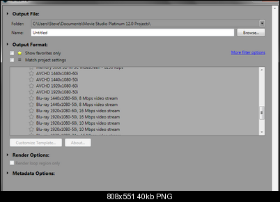

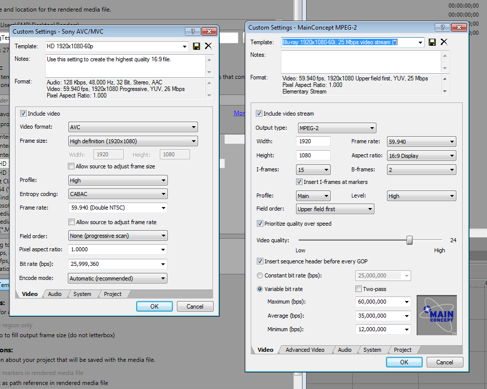

    Here are pictures of what I see with Studio Platinum 12: As you can see... no options for 60p :T Not even the bluray 25Mbps one.
Name:	Custom Settings.png
ID:	22391Click image for larger version
ID:	22392Click image for larger version
Name:	Project Settings.png

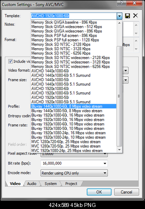

    I use Vegas Pro not studio or whatever you are using. Try selecting 1920 x 1080 60i, then click on the "Custom" button and edit the Render Setting in there. It should look something like below. If all else fails, then frameserve out any encoder you like with the DebugMode Frameserver.
