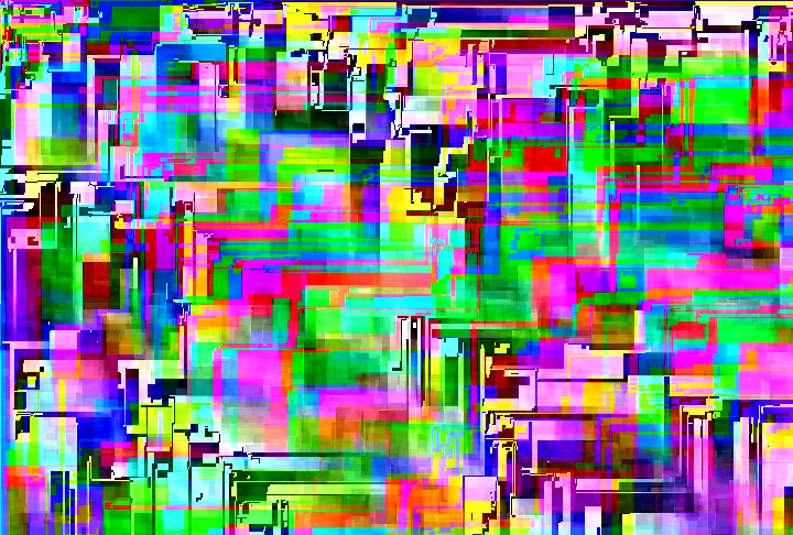

    I've been spending time testing this all the way through....
    If you recall, I create framemd5's.
    • Create a framemd5 only on the source
    • Create a framemd5 for the FFV1 when going from v210 -> FFV1 (you can see this in prior posts)
    • Create a framemd5 going from FFV1 -> v210.
    Going from v210->FFV1 the framemd5's are matching. That's great!
    However, going from FFV1 -> v210 which is back to the original, I'm getting corrupt frames now and then on the decompress. How did I know there was corruption? I compared the FFV1->v210 framemd5 to either the original source (framemd5) or the v210->FFV1 framemd5 and they didn't match. Checked the frames and saw corruption!
    Here's an example of a bad frame:

    So:
    • Original v210 -> FFV1 framemd5's match between the two. So the FFV1 lossless should be correct.
    • Lossless FFV1 -> v210 the framemd5's MOSTLY match, but now and then I get a bad frame or 5 in a row.
    Right now, I'm decompressing again to see if the blip happens to be in the same spot.
    Glad I've not deleted my original's yet!

    Any new info ? Is it random or repeatable ?
    That screenshot is remeniscent of reported "random" lagarith glitches that I mentioned earlier. There was speculation that it was due to floating point calculations, but that was debunked by the author. Basically nobody knows why it happens for the lagarith case
    Those observations don't make sense, because FFV1's framemd5's are decoded and converted to raw YUV in order for them to be measured . That suggests the problem isn't encoding or decoding of FFV1. It suggests the problem is encoding v210. Eitherway, I've never heard or seen anything like that from FFV1
    Is it possible there are more problems with your samples ? Certainly that 1st sample had a problem on the 1st frame.
    FFV1 v1.3 actually has a multithreading -slice and -slicecrc option and several other poorly documented options . Not sure what they do or how to use them properly . Maybe the -slicecrc gives another layer of confidence, not sure

    Since we last chatted, in the background I've been converting my uncompressed v210 files to FFV1. So, it's taken a good few days to allow my machines to convert some of the files over since they are quite huge and since I have a lot of them. I've stuck with FFV1 since it's all inclusive in ffmpeg. As you have made note, you don't get that much additional compression using x264.
    In answering your question, I've not been able to re-create the bad frames on decompression from FFV1 back to v210. For whatever reason, I did get some bad frames when I made my last post. But, then I decompressed from the SAME EXACT FFV1 file and there were no bad frames. Kind of a . I thought during that post, that I was faced with a new issue or problem with ffmpeg. But, that doesn't seem to be the case.
    I remember when decompressing and ended up with bad frames, I was doing a lot of other heavy multi-tasking stuff on my system. The only thing I can think of is that on decompression, if you somehow impede the decompression (starve ffmpeg or stall it), that it may throw in a bad frame or two? In all other tests, I've purposefully decompressed on a system that was not interrupted by anything else. And since then, I've not been able to re-create bad frames on decompression from FFV1->v210. It's been working flawlessly! The framemd5's are helpful at ensuring that everything is working as it should.
    On a related issue to my original post, I've been trying to find a solution to my 10 Bit RGB 444 r10k problem. So far, both ffmpeg and x264 seem to be able to compress from r10k (10 bit RGB 444) to either FFV1 (in the case of ffmpeg) or mkv (in the case of x264). However, the problem is decompressing back to r10k. ffmpeg reports the same issue with the FFV1 or mkv files on decompression (I made mention to this on post #17 https://forum.videohelp.com/threads/361133-Lossless-%2810-Bit-RGB-444%29-and-%2810-Bit-...=1#post2290391):
    full chroma interpolation for destination format 'rgb48le' not yet implemented
    So, I'm trying to find an alternative decompressor. But no luck with that so far. I'm using a windows based "zeranoe" ffmpeg build. I thought perhaps if I found a Linux version of ffmpeg, that maybe it would have the chroma support implemented. But, I've not investigated this further. However, I have contacted those that create the windows "zeranoe" build and am waiting for someone to provide some feedback. Soon as I get that, I'll be sure to post the update here.
    In summary, things are going great with the uncompressed v210 to lossless FFV1 using ffmpeg! So I've been enjoying getting those converted over. But, so far, it seems I'm stuck with the huge r10k files until I find a solution to decompress those. The only solution is archival software! But, it seems that can take roughly 20 hours per file on the tightest compression method. Whereas, like when compressing v210, it's practically real-time (emmmm, so maybe about 2 hours). The biggest benefit to FFV1 is not only the compression, but the fact I can still view the video files which is a nice plus .
