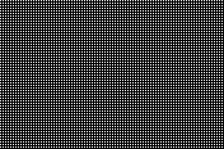

  2. Make the video sepia toned (if that's what you want) and overlay a black "graph paper" grid.

  4. Just make one with a paint program. Black lines on a white background. I should only take a minute or two with with copy/paste operations. You can use the image as it's own transparency map.

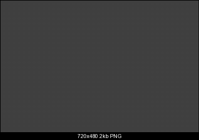

  6. For example, a 720x480 grid:
    Click on the image a few times to get the full size version.

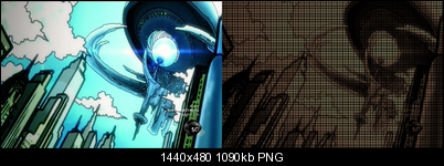

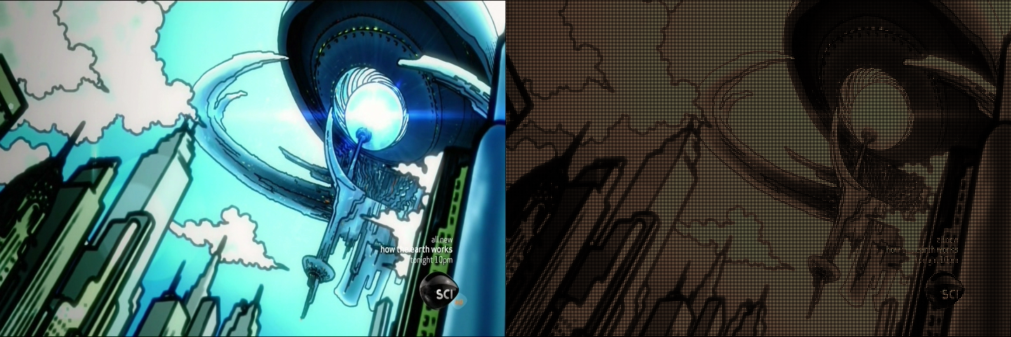

    Before/after sample:
    That was done with AviSynth but the concept will work in Vegas. Invert the colors of the grid to make the transparency map.
