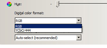

    If you set the graphics card to RGB mode you shouldn't have chroma subsampling issues.
    You mean this?
    Sorry, but it doesn't change anything on how HDMI is still looking inferior. Can it be the quality of the HDMI cable?

  20. Originally Posted by rotchild View Post
    You mean this?
    [Attachment 22326 - Click to enlarge]
    Yes, I meant that. YCbCr 4:4:4 should be fine too. With chroma subsampling white text on a black background will still be perfectly sharp. But colored text on a colored background will be fuzzy. Because color information is sent with lower resolution than the greyscale picture.
    Did you set the graphics card to the TV's native resolution? Did you disable overscan compensation on the graphics card? Did you disable overscan on the TV?

  23. Member turk690's Avatar
    Jul 2003
    ON, Canada
    I have experienced this before. I have an LG M237WA TV that has 2 HDMI, 1 DVI, and a PC D-sub inputs. Using any of the TV HDMI inputs to connect a VGA card with a DVI output through a DVI-to-HDMI cable always produces inferior-looking images compared with just plugging the card DVI output straight to the TV DVI input. There seemed to be something associated with DVI & analog D-sub=VGA cards, HDMI=blu-ray players, etc. This was my impression, at least until I tried connecting a professional NEC LCD with DVI-to-HDMI with same initial grotty results. I went through the NEC settings and one of them was for picture gamma; I don't recall specific figures, but gamma presets for PC output was different from HD video; custom ones could be assigned. When I set it to PC, the picture became OK, as much as would be expected from a VGA card output.
    So, it's still true that DVI and HDMI are electrically the same, but some settings are associated with one or the other and may or may not be changed, depending on the monitor. In my experience, I noted that on the LG I had, overscan can be changed with HDMI but not on DVI inputs (neatly associating HDMI with HD video, and DVI with PC video card output, where overscan is seldom needed or a concern). And unlike the NEC, the LG had no settings for changing gamma on individual inputs so forcing a DVI-sourced signal (which its designers (not nearly correctly) assume can only come from a VGA card) produces the less-than stellar picture quality through the HDMI inputs.
    For the nth time, with the possible exception of certain Intel processors, I don't have/ever owned anything whose name starts with "i".
