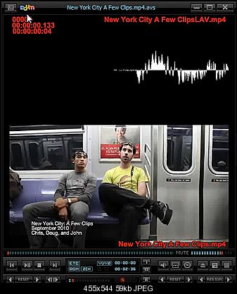

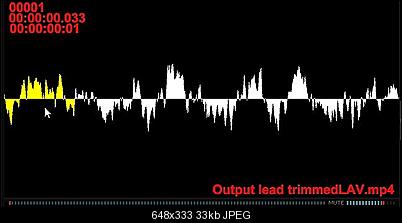

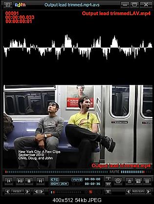

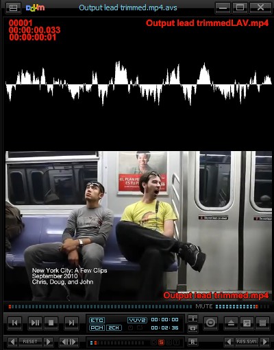

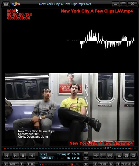

    UPDATE: The left video is the original. Notice the audio does not come in until 0.133 or 3rd frame.:
Name:	ScreenHunter_46 Dec. 25 22.41.jpg
ID:	22347Click image for larger version
Name:	ScreenHunter_46 Dec. 25 22.52.jpg
    The video on the right is with 0.134 trimmed from the beginning. This cured the late start and it was as close to the original MediaInfo as I could get from YouTube. Hope it works.

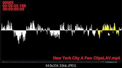

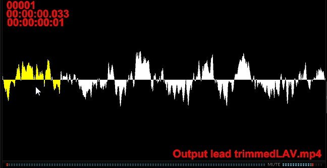

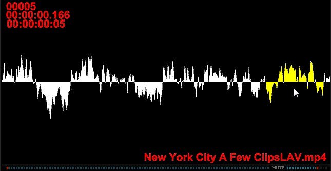

    ffmpeg -i filename -ss 0.046 -vcodec mpeg4 -b:v 170k -s 320x240 -acodec libfdk_aac -b:a 32k -ar 44100 -ac 1 output.3gp
    By adding -ss 0.xxx AFTER the -I video it should make the seek more accurate (https://trac.ffmpeg.org/wiki/Seeking%20with%20FFmpeg) but you would only know that (if it even works) by graphing the audio or making note of the delay from the CONVERTED 3GP.
    NOTE: .046 is about 21.74 FPS and since I doubt that is your frame rate on the original so where you would end up is probably more likely 2 X Frame Rate. With my example I actually ended up around 150MS seeking to 133ms as shown below. Personally I would just leave it if it truly is in sync and plays fine otherwise it will be a trial and error method unless someone has more information or your original video.
Name:	ScreenHunter_46 Dec. 26 06.13.jpg
    Seeking to 0.133 seconds
Name:	ScreenHunter_47 Dec. 26 06.13.jpg
    original, locating start of Seek result above
    Last edited by Budman1; 26th Dec 2013 at 06:27. Reason: proof reading after coffee
