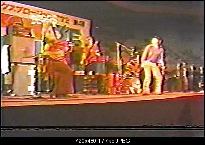

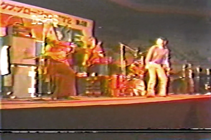

    Looking for something that will do interpolation of dropout areas within a specific frame when there aren't clean adjacent frames to use ReplaceFramesMC()
    Thanks.

  2. There are no good approaches or shortcuts in that case. If there are no good clean directly adjacent (temporal) areas , you can only look at spatial interpolation , textures within the same frame
    Some techniques like inpainting (there are a few in avisynth using masks) might reduce the amount of work you need to manually do , but it's probably better / easier to do a good spatial repair in photoshop
    So the answer is painting or photoshop (clone brush/stamp, healing tool etc...) if you want it looking half decent
    If there are distant adjacent "good" textures (not directly adjacent), then you can still mix & match areas with masks in a compositing tool . One way to speed that approach is use motion tracking techniques to "cover" over the bad areas borrowing textures from good areas many frames away . Obviously these techniques have problems when the content is unique (eg. faces) or motions are complex

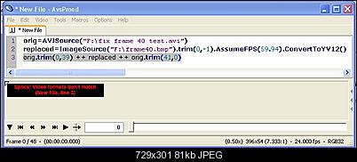

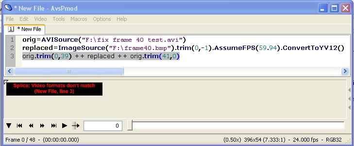

    I'm using a 47 frame sequence, trying to replace frame 40. It's not cooperating, here's what I'm getting. The file is 59.94 progressive, I get the same thing when I use AssumeFPS(60000,1001) - what's the 1001 indicate?
    I gather the first orig.trim() command includes from 0 up to the frame preceding the fixed frame and the second one is the frame following the fixed frame to the end of the file or previous to the next fixed frame, correct? You can specify replacement of more than one frame, yes?

  11. 59.94 is a 2-decimal approximation. The real framerate is 60000/1001 . Add AssumeFPS(60000,1001) after AVISource and for replaced
    What format is your AVI, what colorspace ?
    Yes, but then you have to change the ImageSource() arguments for an image sequence of the correct number of frames

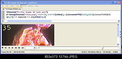

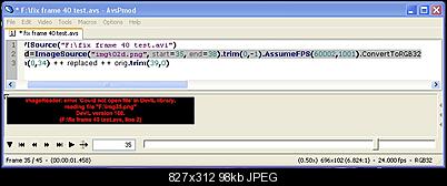

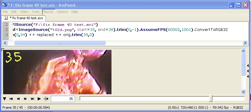

    Looking at the ImageSource command, I'm not clear how that wildcard syntax works. I took 4 frames 35 - 38 and marked them with a frame number in Paintshop to determine whether they were being loaded in the right place and named them 35.png, 36.png, 37.png, 38.png.
    Doing it this way obviously isn't the answer:
Name:	sequence problem1.jpg
    If I do it like this I only get frame 35 and not the other 3.
Name:	sequence problem2.jpg
    How do I specify to load files 35.png, 36.png, 37.png, 38.png ?
  17. The 1st one didn't work because your files don't have img000.png as shown in the example . The "img" prefix is missing. Obviously you figured that out
    Remove the Trim(0,-1) from "replaced" . Remember that only returns the 1st frame used in the single image case
  18. Member brassplyer's Avatar
    Apr 2008
    Thanks I'll give it a try.
    Now what if I want to do different sequences of frames in different parts of the video? This doesn't work - it only executes whatever the last sequence referenced is.
    orig=AVISource("F:\fix frame 40 test.avi")
    replaced=ImageSource("%02d.png", start=20, end=22).AssumeFPS(60002,1001).ConvertToRGB32
    orig.trim(0,19) ++ replaced ++ orig.trim(23,0)
    replaced=ImageSource("%02d.png", start=35, end=38).AssumeFPS(60002,1001).ConvertToRGB32
    orig.trim(0,34) ++ replaced ++ orig.trim(39,0)
    What's the avisynth plugin that reads my mind and autowrites the script to do what I want it to do?
  19. Originally Posted by brassplyer View Post
    Give them different names
    orig=AVISource("F:\fix frame 40 test.avi").AssumeFPS(60000,1001)
    replaced1=ImageSource("%02d.png", start=20, end=22).AssumeFPS(60000,1001).ConvertToRGB32()
    replaced2=ImageSource("%02d.png", start=35, end=38).AssumeFPS(60000,1001).ConvertToRGB32()
    orig.trim(0,19) ++ replaced1 ++ orig.trim(23,34) ++ replaced2 ++ orig.trim(39,0)
    When you have more complex or multiple sequences and layers, it might be easier to use a video editor, where you can graphically see what is going on in layers

    Yes, you just "cover up" the video with replacement frames . Also benefit of doing it in an editor, is you have masks that you can more easily use to "cover up" parts of a frame . But if there are only a few edits, or if they are complete frames, it's simple enough in avisynth
    This is what replaceframessimple syntax might look like . You need a "real" frame 0 to get ImageSource to start reading the sequence
    orig=AVISource().AssumeFPS(60000,1001)
    replace=ImageSource("%02d.png", start=0, end=whatever).AssumeFPS(60000,1001).ConvertToRGB32()
    rfs(orig, replace, mappings="[20 22] [35 38]")
    If you have many mappings, you can use a text file to list the replacement frames
  24. I debugged it. This works with names like "pic00022.png":
    # assuming YV12 video
    function ReplaceFramesWithImages(clip vid, int first, int last, string basename)
      replacements = ImageSource(basename+"%05d.png", start=first, end=last).ConvertToYV12().AssumeFPS(vid.FrameRateNumerator, vid.FrameRateDenominator)
      Trim(vid,0,first-1)+replacements+Trim(vid,last+1,0)
    AviSource("video.avi")
    ReplaceFramesWithImages(last, 22, 24, "pic")
