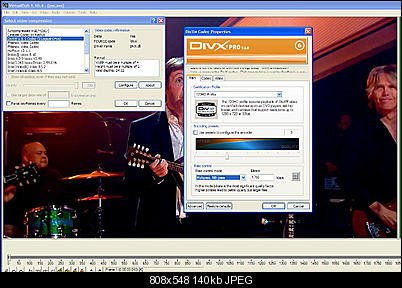

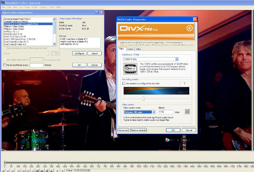

    I don't have the particular version of xvid installed, so my test is meaningless.
    Perhaps try uninstalling that version, and install AutoGK and use the version that comes with it.
    See if you get the same issue. (This is the version I use). I also have the Divx 6.85 codec installed,
    on a second XP install. I currently encoding a short music video, 1080p source, 25 fps, at 1750 kbps 720p,
    using Virtualdub. It looks terrible, but I get the bitrate I asked for.
    Here's the result.
