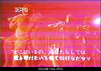

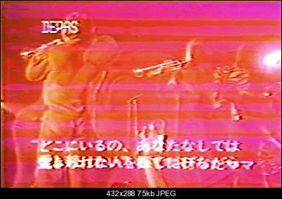

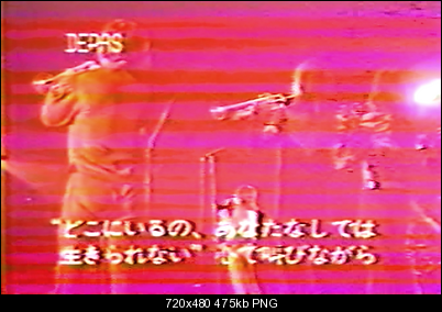

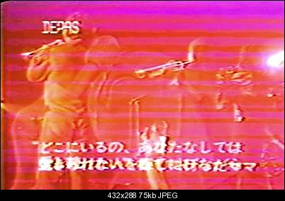

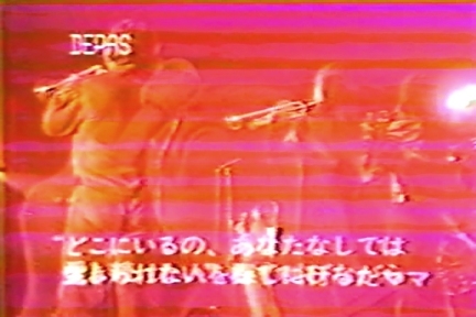

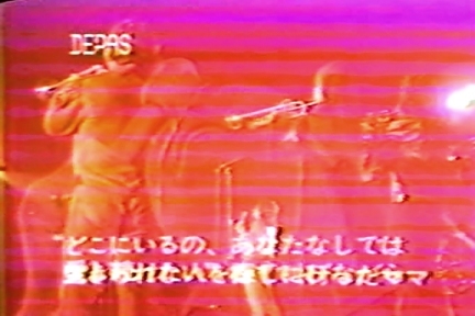

    Things like this where there's problems that change from frame to frame. Sequence of 4 consecutive frames.

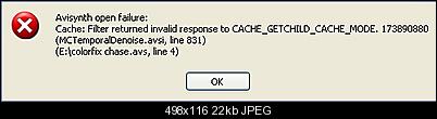

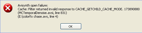

    Trying this script:
    avisource("F:\sourcefile.avi")
    ConvertToYV12(interlaced=false)
    AssumeFPS(59.94)
    MergeChroma(McTemporalDenoise(settings="very high"))
    Getting this error:
Name:	Avisynth error.jpg
  4. For the cache error: SetMtMode(). There's something borked in the mt build that requires an explicit SetMtMode() call when using many filters.
    But I downloaded the four images and MCTD doesn't work well. Most of the noise is in the U channel, a little in the Y channel. Avideo sample would be better.

  6. Member brassplyer's Avatar
    Apr 2008
    Okay, added SetMtMode(3,4) to it and it loads. The script as posted doesn't make much difference. Knocks down the bright purple peaks a bit but the noise "flames" are still quite evident.

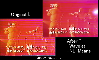

  9. Can't remove those stripes completely, but made it less annoying.

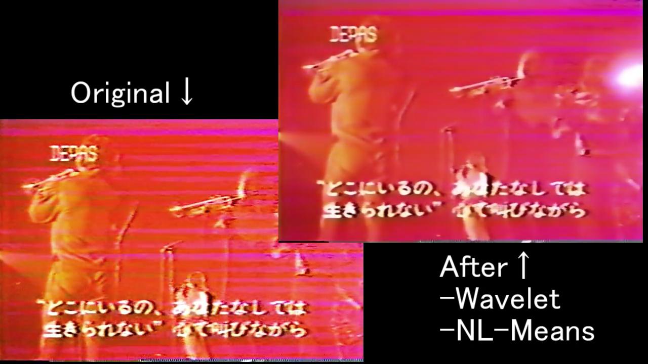

    Looks good. Script?
  11. Originally Posted by brassplyer View Post
    Looks good. Script?
    No script is needed because I didn't use Avisynth. Instead, I use AviUtl, with the NL-Mean and Wavelet denoising plugins.
    (I have not release the English version of the wavelet denoise plugin yet... after the holiday maybe.)

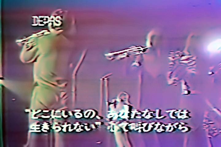

  24. Member PuzZLeR's Avatar
    Oct 2006
    Toronto Canada

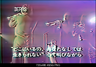

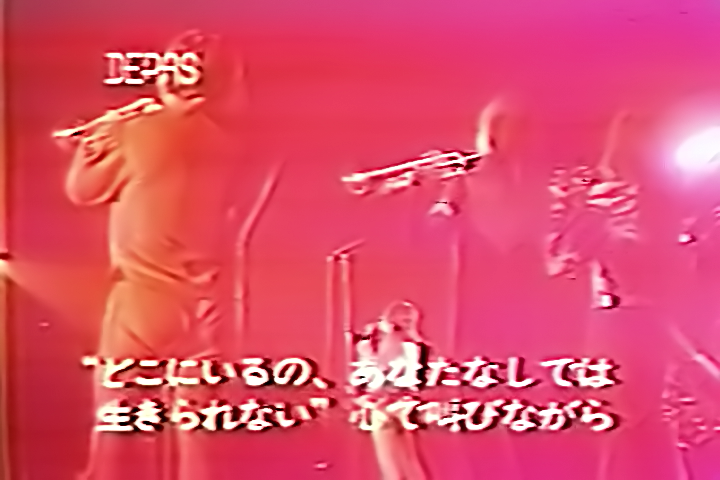

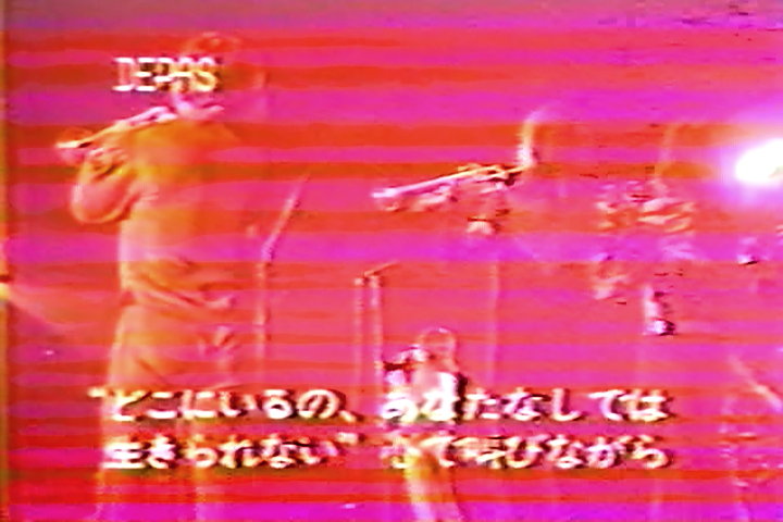

    You can do it with Neat Video. All depends on what you define as your noise profile. In this case I had to do two passes, one for the pinkish streaks, and another for the off-reds.
    You can compromise with the Y (luma) channel on this one - more color adjustment at the cost of (maybe) some detail. You can indeed remove all the color streaks, but the picture may look a bit smoother (however, you may be able to achieve it all with a bit of time and nitpickiness).
Name:	colornoise - source.png
ID:	22583Click image for larger version
Name:	colornoise - adjusted.png

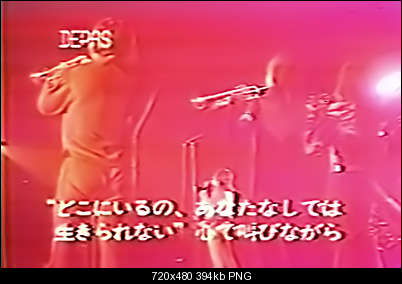

    If you want to be picky after the fact, you can play around with some color filters, such as VirtualDub's Color Mill on the adjusted video to give it a more natural feel (especially since that red was giving me an eye sore).
Name:	colornoise - adjusted2.png
    Either way, this was to give you an idea, since there are probably millions of other combinations you can play with (gamma, levels, etc), but the new image may still need more streak removal (and will likely never look very good).
