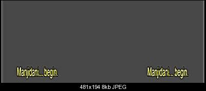

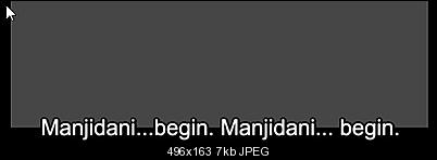

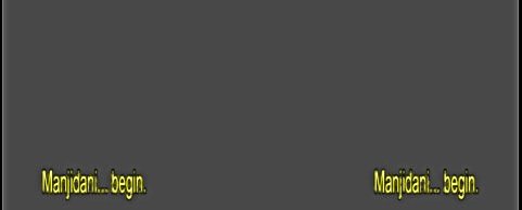

    Did a little experimenting and don't know if its the same as in your case but, I created 3D idx/sub subtitles from 2D subtitles and they were indeed elongated as well as duplicated on each frame. I used Subtitle Edit and they OCR'd back to 2D OK but of course there were duplicate entries for each line. I'm not all that familiar with 3D subtitles but I would assume the duplicates are for making them 3D and converting back is going to show both lines in 2D. That doesn't sound like an easy fix except to use an, as yet, unwritten program.
Name:	ScreenHunter_46 Dec. 22 22.50.jpg
    3D subtitles
Name:	ScreenHunter_46 Dec. 22 22.51.jpg
    Back to 2D subtitles

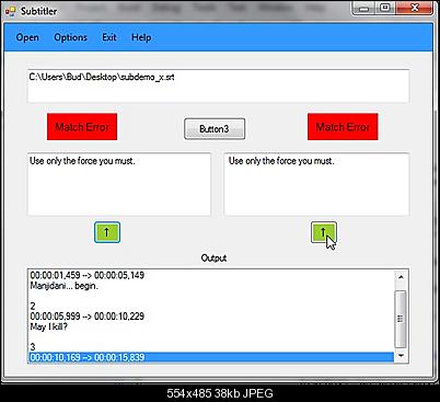

    Okay, just wondered if anyone still needed a quick and dirty method to UN-3D subtitles. Almost done with version below that will parse the double lines but not much error recovery and I'm sure there would be a ton of suggestions. Only for SRT at moment...
Name:	ScreenHunter_46 Dec. 24 16.19.jpg

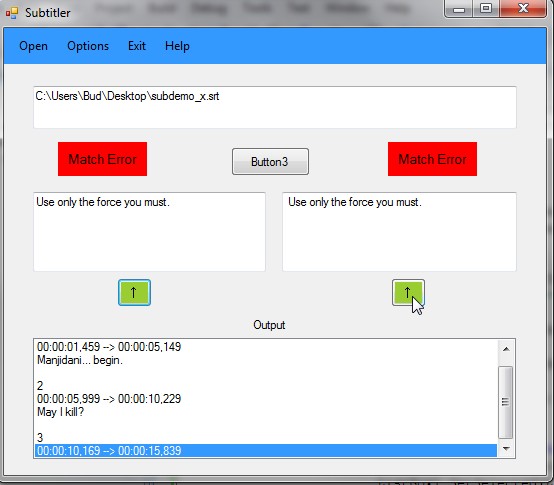

    Okay, piece of cake. I'll try to attach a zip file here with the subs you sent and the parser that I used. You just drag and drop the srt file to the top box and then hit convert. It saves all the number lines and the time lines and parses everything else into 2 panels. If they are the same, it willsave but if they are different, you just correct and/or hit the ones you want (green arrow). I added an auto checkbox for those that are essentially the same except spacing so you don't have to click all the time. It creates a nameNEW.SRT file so your original is safe.
    There were only 366 lines covering the 01:40:00.00 + movie? That's all I found in the sub/idx you sent. Let me know if it works for you as well.

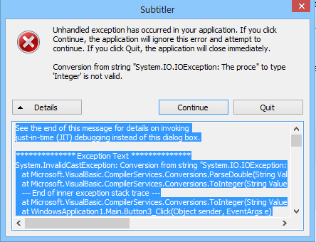

  14. I get errors when clicking convert:
    Full log (no key): Pastebin
    Also, yeah it's only 366 lines cuz Arnold never talks a lot in his movies lol. Also your .srt is a mess too lol, I don't even recognize some of those letters, I hate it when it converts letters to different letters/characters. Also no spaces and etc.

    okay I updated the program and verified by using the Subtitles you sent. I disabled the convert button after the first click so only the left and right okay button work until its done. The link above should have the new one with Date of 12/27 09:53 PM
