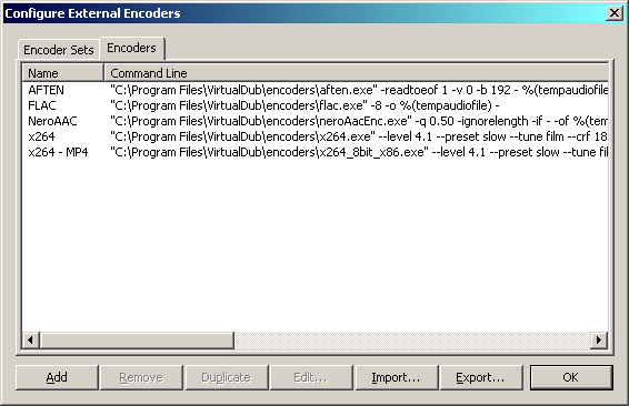

    1. In command line, you have to write ALL the commands. When you just do 1 task, its a piece of cake. Issues come when you have to do multiple tasks with many files, one after another.
    You don't have to write ALL the commands. You only need to write the ones you're using which differ from the default settings.
    Originally Posted by luisppk View Post
    Hope this answer is enough for you.
    No.... because when you create a commandline and save it in VirtualDub's encoder configuration, you can save it as a preset, so you can have multiple x264 encoder configurations all using different settings and easily select the appropriate one for encoding. There's no need to create a commandline from scratch every time you encode. Have you even tried using VirtualDub's external encoder feature?

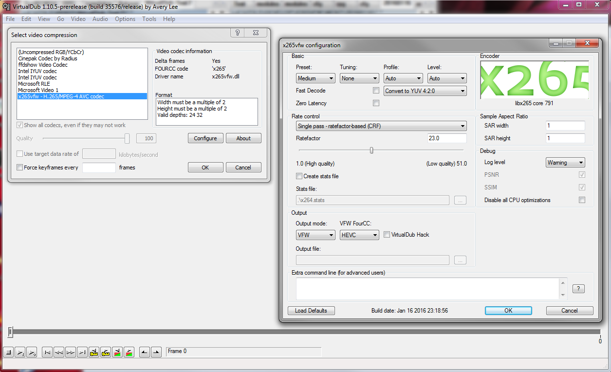

    I am using Virtualdub 1.10.5 test7 32bit in Windows Pro 64bit. I don't see x265 in the encoder list and if I try to configure under Start menu, Windows says that it cannot find the dll. I searched my pc for x265vfw.dll and tried to manually register it but I get the same error message. Cannot find the dll module.
    My interest is to see if I can Smart Render x265 and also get drag and drop support but I see that is not possible since it is only an encoder.

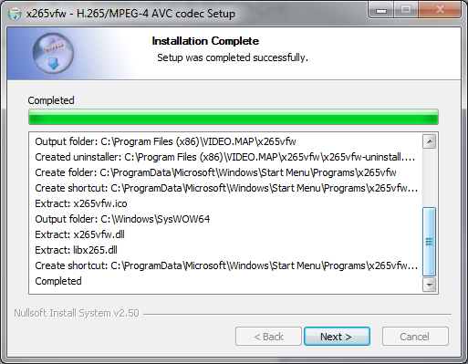

  19. Windows 7 Enterprise 64-bit
    At "Installation complete", press "Show details".
    Please check the attached pictures for reference(s).
    What is the difference at you?
    Nov 2002
    Installation is identical except your Output folder is VIDEO.MAP and mine is x265vfw.
    There is no x265vfw under Select video compression so there is no x265vfw Configuration.
    Trying under Start Menu... There was a problem starting x265vfw.dll
    The Specified module cannot be found.

    Trying to install now too...
    Nit: In the installer header, you can read "x265vfw - H.265/MPEG-4 AVC codec Setup"; but it's HEVC, not AVC. Same in the installation finish page.
    C:\Program Files (x86)\x265vfw contains x265vfw-uninstall.exe and x265vfw.ico - OK.
    C:\Windows\SysWOW64 contains x265vfw.dll and libx265.dll - OK.
    VirtualDub 1.10.4 shows no x265vfw codec while no source video is loaded. Also not while a video is loaded.
    No "VIDC.HEVC" or "VIDC.X265" entries in HKEY_LOCAL_MACHINE\SOFTWARE\Microsoft\Windows NT\CurrentVersion\Drivers32 (that would be the 64 bit VfW section; no problem).
    There is a "vidc.x265" entry in HKEY_LOCAL_MACHINE\SOFTWARE\Wow6432Node\Microsoft\ Windows NT\CurrentVersion\Drivers32, referring to "x265vfw.dll". Looks OK here.

    ^ Yes$S, now it works as it should on Windows XP
    However the interface still needs to be improved a lot...
    some users will not like the presets thing, and the help button is totally unhelpful
  24. Member
    Nov 2002
    Can't open HEVC in Virtualdub (without ffmpeg supported files) as expected. Can't use Smart Render or Direct Stream Copy on existing HEVC file like x264 can with AVC1. x265 is slightly faster than x265vfw and x265vfw doesn't print any statistics (quiet mode?). Virtualdub crashes if I tick VDub Hack but runs fine without it.
    Will be helpfull for users that use x264vfw and users that are afraid to learn to use the external encoder in Virtualdub. What we really need is an updated ffmpeg with x265 support and an x265 input plugin for Virtualdub.
    I would use this vfw version if it had at least Direct Stream Copy and preferably Smart Rendering. Oh and HEVC Input Support like x264vfw has for AVC.

    So, the v110 release is out, here too:
    https://sourceforge.net/projects/mpxplay/files/x265vfw/x265vfw_v110_x265b80
    This installer is always the latest x86 version from now:
    http://sourceforge.net/projects/mpxplay/files/x265vfw/x265vfw_x86_latest.exe
