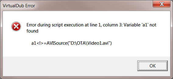

    When I tried to run this AVS script through VirtualDub but I get the error below. Any help? Thanks.
    a1=AVISource("D:\OTA\Video1.avi")
    a2=ImageSource("D:\OTA\Logo.png",pixel_type="RGB32")
    a3=Overlay(a1,a2,mask=a2.ShowAlpha())

    Don't see anything wrong with your script but it says line 1, column 3 and that's your '=' sign or there's something between the 1 and =. Might try to retype it or use another variable like a, b, c and try again to make sure it isn't the actual a1 variable?
    Trying to put a transparent logo on a video?
  3. Nothing's going to happen in that script , if we're being shown the entire script. I don't know about the rest of it but the result isn't a video file. Maybe add:
    Return a3
    at the bottom and see what happens.

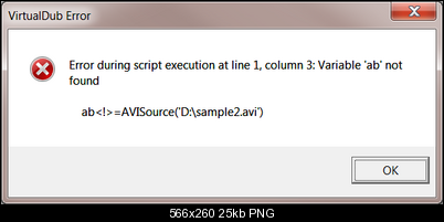

    Yes, I tried to add a simple water mark.Later, I'll display for 5 seconds for every 20 seconds in the video.
    Here is the entire code, no difference except I give it a new variable name. The code is from how to add watermark guide thread.
    ab=AVISource('D:\sample2.avi')
    ac=ImageSource('D:\logo.png',pixel_type='RGB32')
    ad=Overlay(ab,ac,mask=ac.ShowAlpha())
    Return ad
    I still get the same error.

  5. Originally Posted by kj1983 View Post
    Return ad
    [Attachment 22346 - Click to enlarge]
    They should be quotation marks "" , not apostrophe ''
    ab=AVISource("D:\sample2.avi")
    ac=ImageSource("D:\logo.png",pixel_type="RGB32")
    Return ad

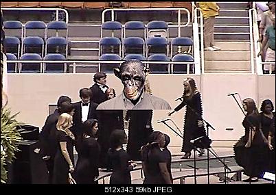

    Just got done testing and had the same results using AVISource or Directshowsource so I used my standby, FFMPegSource.
    After running this it displayed perfectly with transparent logo:
    LoadPlugin("C:\Program Files (x86)\AviSynth 2.5\plugins\ffms2.dll")
    v = FFVideoSource("C:\Users\Bud\Desktop\Transparent\sa mple.avi")
    A = FFAudioSource("C:\Users\Bud\Desktop\Transparent\sa mple.avi")
    ab = AudioDub(V, A)
    ac=ImageSource("C:\Users\Bud\Desktop\Transparent\b ud 198x133.png",pixel_type="RGB32")
    ad=Overlay(ab,ac,x=250, y=150,mask=ac.ShowAlpha())
    Return ad
Name:	ScreenHunter_46 Dec. 25 23.40.jpg
    Comment out all but the avisource line and make sure that plays okay. Mine didn't with either DirectShow or avi sources. Hope it helps.
    UPDATE: If you want the transparent watermark type just change overlay line to:
    ad=Overlay(ab,ac,x=250, y=150,opacity = 0.3,mask=ac.ShowAlpha())
    Opacity runs from 0.0(transparent ) to 1.0 (fully opaque)
