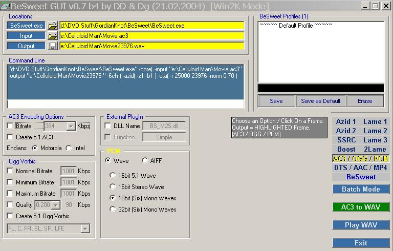

    How do you do that?
    In the AC3/OGG/PCM section of BeSweet is a box to tick to give you 16bit (Six) Mono Waves:
    * Edit later: I see poisondeathray showed you how to make it CFR again, in the other thread.

    The 23.220 -> 25 audio is in sync. I would say 99.9%.
    To be totally honest I don't know if the 0.1% is really there or it's just me being too pedantic.
    Anyway, I will be sure only when I see the whole thing, from start to end.
    Thanks for the BeSweet tip.
