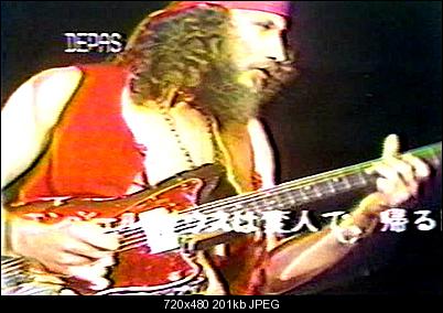

    Afaik with hot spots aside from some hifalutin' CGI redraw of the frames you can't make it any better than what exists in the source material - what's here looks like the source as far as that goes. For example, this is a frame from a direct crop and deinterlace with QTGMC from the original mpg. It's not something I did to it it's just the way it is.
    As far as block noise, deblocking doesn't seem to do squat. I get much better results - which is to say *any* result using the onboard Virtualdub smoother plugin or the Donald Graft Smart Smoother.

    Really couldn't say that deblocking or any other technique would work, or make it better or worse. What you've submitted isn't the source. Can only describe what you've processed in your post.
    Deblockers and debanding tools seem to work for most users. But without the source, no can say.
