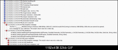

    I hope I'm putting this in the right part of the forum. This is along the same lines of what I've asked before in having to re-encode an MKV file because of it originally being done at the wrong level (it was encoded from from Blu-ray using L5.0 which my OPPO Blu-ray player will not play)
    Firstly, I saw what LOOKED like this really helpful program called H264 Level Editor which SUPPOSEDLY would change the file header or something and re-write it as L4.1. But, after burning it to disc, my player pixilated all over the place.
    So, re-encode time...
    I tried MeGui because it is pretty clearly understandable as to how to set it. I used the presets very carefully and set it for High, 4.1, tune-film, CRF-18, Slow. I set it to keep the same AR and not to crop or resize. I checked as it wrote the script in the box below and everything looked fine. I double-checked the advanced settings so that I could see every one individually and they all looked fine. I think I just tweaked Trellis to 2 instead of 1 and BPyramid to 'Strict' because ultimate I would be playing it on my player (don't know if that was necessary...) Other than that I left the presets in place. But, when I started the encode process, it extracted the A/V streams, and created the ffwhatever file, and then it just quit. I took a snapshot of the log; hopefully I will be able to insert it here.
    Honestly, even though I am definitely NOT a pro at this, the settings are pretty self-explanatory. I'm just wondering WHY the heck it quit. The log LOOKS like it was something to do with Avisynth, like it wasn't installed (I had also previously tried STAX and got what LOOKED like a similar error with 'Not being able to read the .avs file) but I re-installed the newest version of Avisynth, just to be sure and it did it again.
    I really am puzzled by why this quit on me; any help would be lovely!

    If you set the output resolution to '0x0' the encoder can't make a valid video track.
  3. I think the resolution being set to 0x0 is some sort of OneClick encoder bug when specifying "keep aspect ratio". I've seen it mentioned in the MeGUI thread at doom9. If you specify a resolution I think that'll fix it (I don't use the OneClick encoder myself), or rather than use the OnceClick encoder, do it "manually".
    Open the original video using the File/Open menu, add the indexing job to the queue and run it. MeGUI will index the video and extract the audio. The AVS Script creator will open with a preview. If you want to re-encode "as-is" (no cropping or resizing etc) just save the script.
    The AutoEncode button will let you set up a job which will output an MKV/MP4 containing the video and audio. If you want to keep the original audio rather than re-encode it, use the "x" button to clear the audio section first. After clicking on AutoEncode, check the box for adding additional content. That'll let you add the extracted audio.
    AutoEncode lets you use the existing x264 encoder settings or specify a file size. If you choose "no target size" it'll use CRF (quality) encoding if the encoder is configured that way. If you specify a particular file size MeGUI will switch to 2 pass encoding for you.
    You shouldn't need to tweak any x264 settings for MKV playback using a Bluray player. The defaults are fine and you can simply specify a desired x264 speed preset and tuning. I generally specify High Profile, Level 4.1, or selecting DXVA as the target playback device will so the same thing (it's the same as specifying High Profile, level 4.1 manually).

    Ah, the most very helpful Hello2!
    Thanks so much; well, at least you guys could bloody well SEE why it did that. I could not for the life of me figure out why. I don't quite understand about using the one-click encoder or not. I basically set all the parameters like L4.1 and tune-film and 'Slow' and I can see all the details for all the parameters, so I didn't THINK that I was using any kind of 'one-click' encoding. I tell it to keep the same audio too. I THINK I set all this on the 'Scratchpads' for Audio and Video separately. And then when I check the 'Advanced options' I then can set or see all the settings for the video, etc.
    I don't quite understand what you are telling me about running the Avs script and all that, sorry... I usually just make sure that all the settings are what I want which is basically just like you said, leave everything alone and just re-encode, and then I click 'Go'. So far it's extracted the audio, run some kind of 'Pre' encoding thing that takes a couple of minutes, and then just quits and the processing window just closes.
    I WILL try though setting the output resolution to the same values as the input instead of simply selecting 'Keep same AR', because I think I DO understand that However, I WISH that I understood what you are telling me to do above, but I don't... The only part that I follow you is 'Open the input file'... From there I don't understand what to do.
