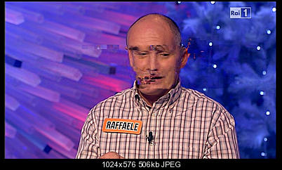

    when I record some tv shows broadcasted via DVB-T using DVBViewer, sometimes some discontinuities happen like the one shown in the following screenshot.
    This is very annoying, especially when you want to record something you care about and wish to store.
    I usually try to fix these errors using either PVAStrumento, Project X or Videoredo and choosing the one which gives me the best results (often Project X).
    Here's my question: is there a way to perfectly fix discontinuities once they happen? I'm talking about, let's say, just one discontinuity in a two hour long file, in other words, not something so bad which would make the video unplayable.
    In the particular case of the screenshot above, for instance, is there a way to fix those blocks?
    Thanks in advance!

    No. The video looks as it does because some of the information needed to construct the video frame is missing, There isn't any consumer software able to restore the missing information automatically.
  3. Originally Posted by FrankDrebin View Post
    Of course not. The compressed video stream was corrupted before it got to you. The only way to fix it is record the show again and replace the bad section.

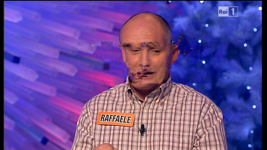

    As far as "creative" editing goes, I did something kind of crazy: I was able to download the episode of the game show I had recorded from the official television channel website. I took the non corrupted frames (mostly the face of the guy speaking) out of the downloaded video, cropped the unnecessary parts away, positioned them right on top of the "discontinuity blocks" showing in my corrupted recording and blurred the edges only a little bit to blend everything together. It's not perfect, of course, but it's certainly better than before, I think.
