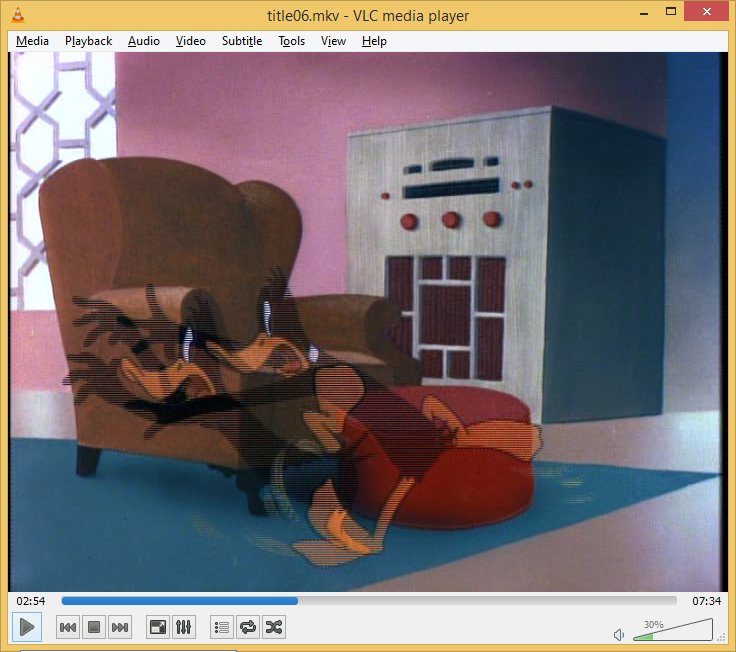

    Anyway, quick question: what's the best way (any encoder/filter/software at all) to de-interlace an interlaced source?
    Screenshot from the DVD:
    https://forum.videohelp.com/images/imgfiles/tkVgkYzh.jpg
  20. Originally Posted by mikehunt69 View Post
    "A video is worth a thousand pictures". 10 seconds of steady motion will be plenty.
    Anyway, for film-based videos (which yours probably is) you don't deinterlace at all - you IVTC with an AviSynth IVTC. For true interlaced video the very best deinterlacer (and you asked for the best) is AviSynth's QTGMC. Several programs (XviD4PSP, for example) can do either.

  22. Member
    Dec 2013
    afghanistan
    Video link:
    http://www.putlocker.com/file/55E1F0D4EA535F3E
    This is 10s of the original MPEG-2 video, not changed from the DVD.
  23. It's film based. It should be inverse telecined, not deinterlaced. Try TFM().TDecimate(). Here it is after IVTC and a little cleanup. It's lost a little detail from the downsize/upsize to get rid of the dot crawl artifacts.
