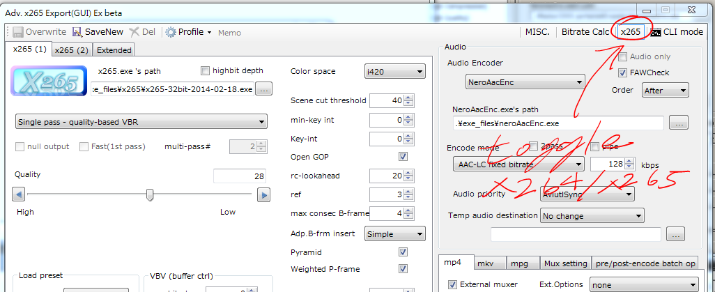

    I just tried to export my video like in the tutorial you had. When it finished all i had was a sound file and no video to go with it. What would i be missing to be able to fix this?
  2. Member racer-x's Avatar
    Mar 2003
    3rd Rock from the Sun
    what are you trying to export to? Avi, mp4, mkv, what? Make sure you follow the export directions.........
    Apr 2014
    Australia
    .mp4, I went to the Export with plugin -> Adv. x265 Export(GUI) Ex beta. Then i selected mp4, I didn't change any of the Video Compression settings, i just left them as the default.
    Then when it finished the file only had audio and no video.
  4. Member racer-x's Avatar
    Mar 2003
    You'll need to go into "Compression Settings", select x265 or x264 encoder. You might have to select the location of the Nero aac encoder if you want to use that.
  5. Member racer-x's Avatar
    Mar 2003
    The default is x265, so it is likely that you encoded an HEVC mp4 file. You probably didn't have the required codecs and was only able to play the audio. You should select x264 encoder in the settings like this:
    Apr 2014
    Australia
    Thanks for that. Changing to that youtube profile worked for me

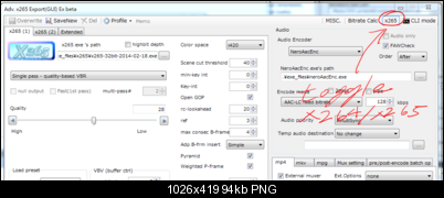

  7. I guess many people without very keen observation will miss this, so just to make things clear...
    You may switch between x264 mode and x265 mode by clicking that "x265 button"

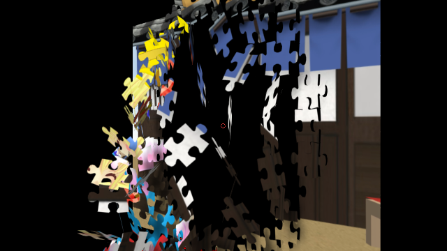

  25. I haven't had a chance to play with it yet but to clarify - It's not "true 3D" is it? ie. it's a 2D layer in 3D space ? or can you extrude the puzzle pieces depth ( so they aren't "flat" ) .
    Anyways keep the updates coming, nice job
  26. Originally Posted by poisondeathray View Post
    Yup, you are correct.
    The "3D" here means the trajectory and rotation of falling pieces are calculated in a 3D coordiante, like this↓
    I think it is possible to modify the script to give thickness... by cloning the piece images along the Z-axis... but that is even more heavy

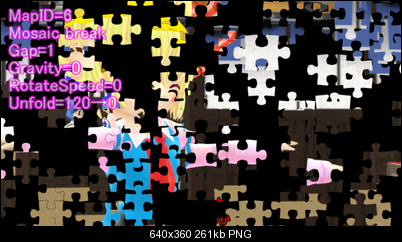

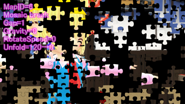

  29. Member
    Jan 2014
    Kazakhstan
    Replace the black background on the images (2D Space required)
    1 layer - simple image
    2 layer - puzzle
    Looks Cool
  30. Originally Posted by Gravitator View Post
    2 layer - puzzle
    Looks Cool
    Like this? ↓
