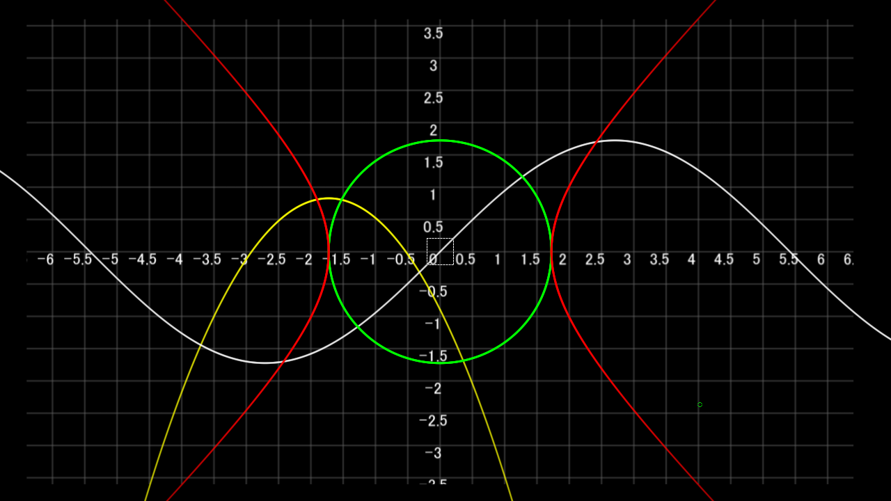

  3. Click image for larger version
    Found a script that plots graph.... should be useful for schools and maths geeks?
    Attachment: Script Archive (use as "Custom object". You may retain or remove the folder structure as long as the files are inside the .\Script folder)

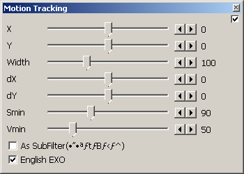

    I tried to use it on my Win7 x64 editing machine. I installed per instructions, but my Motion Tracking Filter box does not have the "Analyze!" button. Without it, I cant go any further. I have no trouble moving and resizing the sensor box. It does the same with both versions you have uploaded.

    Resize the dialog box (the bottom edge)
    Unlike most other plugins, this dialog box can be resized.

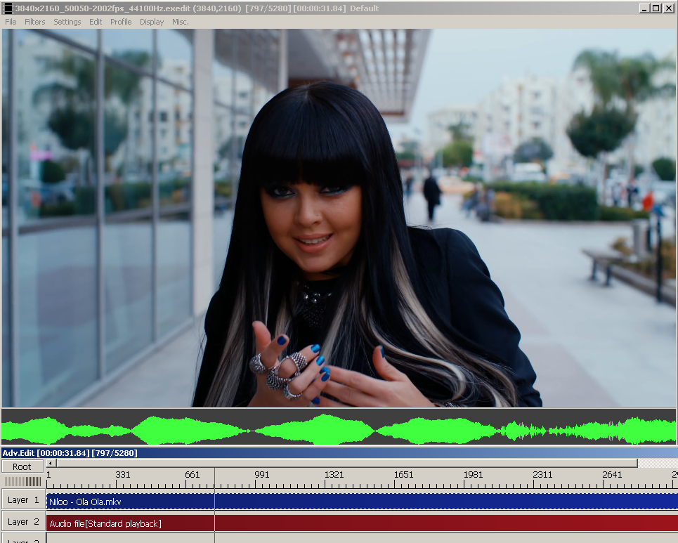

    The program does not give the opportunity to work with UHD files (Depends on the video card?)
    Name:  UHD can not read.jpg
    Trying to look at the behavior of the two clips > https://mega.co.nz/#!xNMW3JTa!qHuGZA-OuwoiqGOc3nTsnN1N6ZL0ifIAS2l72nLsakQ
  24. Member racer-x's Avatar
    Mar 2003
    3rd Rock from the Sun
    Yes it can, but you better have plenty of RAM and a fast CPU...................
    1) Right-Click on Advanced Editing empty layer and select "Preferences" - Set maximum image size to 3840 x 2160 in the boxes and click OK.
    2) In main AviUtl window, click File > Environmental Settings > System Settings: Set Max image size to 3840 x 2160 and click OK.
    3) Restart AviUtl and import your clip.

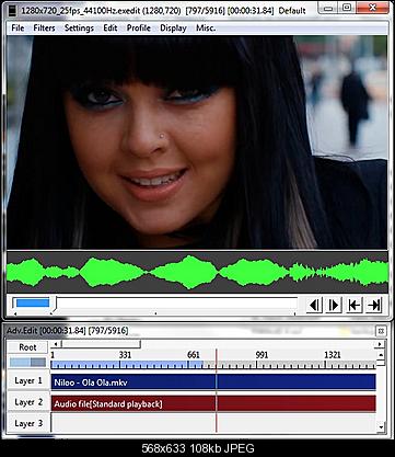

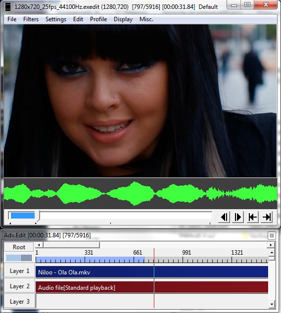

    If it's set to expose layer 1280x720 the program as if cuts the video clip, and it turns out that stretched (picture does not fit into the screen during processing and after encoding) - instead of making a miscalculation to reduce the resolution / resize-adjust screen resolution.
  26. Member racer-x's Avatar
    Mar 2003
    Aviutl doesn't auto resize sources to match project. That's a good thing as this program is not designed with dummies in mind.....
    If you import 4k source, but want to export @ 720p, then you'll either need to apply a resize filter, or use the ZOOM tool and zoom out till the picture fits your screen.

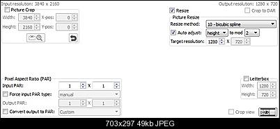

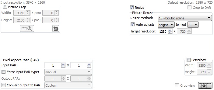

    Or the opportunity to ask for project X-coordinate and implement the automatic adjust
  28. Just create a project at your source resolution, then enable the resize filter(Settings>Resize Filter...).
    Remember to put the resize filter AFTER the "Advanced Editing" entry.
    (better quality, depending on resize method you choose)
    OR
    On your video object(s)...
    >Add filter effect > Basic effects> resize
    if you want to set the final size by pixel instead of percentage, check "specify size by the number of dot",
    then set the X (width)and Y (height) parameters
    (may have a reduction in quality on significant size change)
