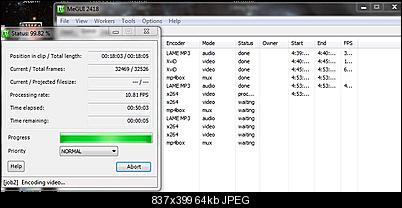

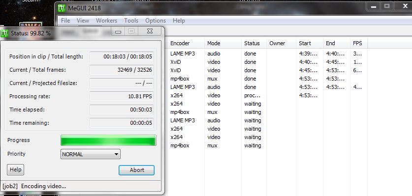

    When i used any profiles of x264 as encoder setting to encode my video...
    the work process hang at about 99%, and the processing rate starts decreasing FPS, time elapsed is keep increasing, but time remaining is 0.
    However, when i used xvid profiles as encoder setting, it works fine...
    * My MeGUI is the latest stable version, and K-lite code pack is the latest version 10...everything is in default setting....i had used MeGUI for quite a long time with no problem, until this issue...
    Please provide me solutions with simple explanation as im still consider a newbie in this field. thanks.
    There is a picture attached here.Click image for larger version

  2. log file usually writes errors, or just post log file ...
    it looks like it has a problem just at the end of video encoding, so perhaps some decoding problem at the end?
    -use Megui's avs cutter (ctrl+D) to cut off the end (~300 frames) in Avisynth script, your's script or script that megui generated for you
    or use CRF to eliminate possible 2pass problem, meaning switching to second pass ...

    thanks for the reply, well, i had found my own solution to this, which is uninstall k-lite code pack (full) and install another code pack; here, i install "final codeces" to replace k-lite...and the problem solve....
    however, i still hope someone can discover the solution for this problem, as i still loyal to k-lite code pack, and this problem was just suddenly pop up from nowhere before and after i update my k-lite; in other words, it means before i update k-lite, it works fine and this problem just suddenly pop up from nowhere, and force me to update to the new version of k-lite, yet problem still not solve.

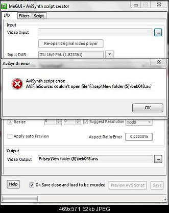

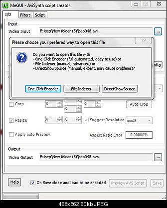

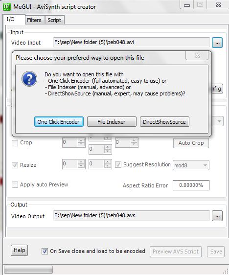

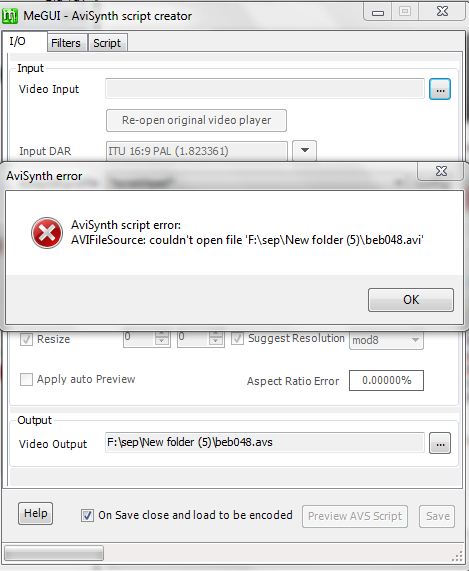

    1 question: when i use meGUI....i click tools--> create avs script, then i import my avi video...why is it sometime it happens to be 'directvideosource' instead of 'avisource'? and when i click 'directvideosource' , i couldnt generate the avs file...
    last time when i import avi file...it shows that 'avisource' instead of 'direct video source' and i can generate avs file with no problem..
    picture a --> picture b....

  13. I don't know why it works sometimes and sometimes not, I dug up one Xvid file here, tried to drop it onto Megui, and I did not get even DirectShow choice there, only One click Encoder or File indexer. And both choices Megui used FFVideoSource plugin to read that file, that is indexing it first. FFVideoSource (http://avisynth.nl/index.php/FFmpegSource) is another, third way how to read video file in Avisynth. Megui is using that plugin too.
    You can always load Avisynth script to Megui directly, not letting Megui create it. You can create it yourself. You make script like:
    AviSource("F:\my_movies\movie1.avi")
    just one line script for example in this case and Megui will load it, so you make it easier for Megui creating it yourself directly.
    Megui is very advanced tool, I bet you'd be much happier using Ripbot264 and that one will too load Avisynth script and Ripbot264 is much more user friendly.
  14. I just tried loading XviD file like you through Megui's Avisynth Script Creator and I got three choices, One Click Encoder, file indexing and AviSource. But no DirectShow choice. I got that one instead of AviSource importing mkv file (with H.264 in it).
    You cannot load H.264 file with AviSource in Avisynth.

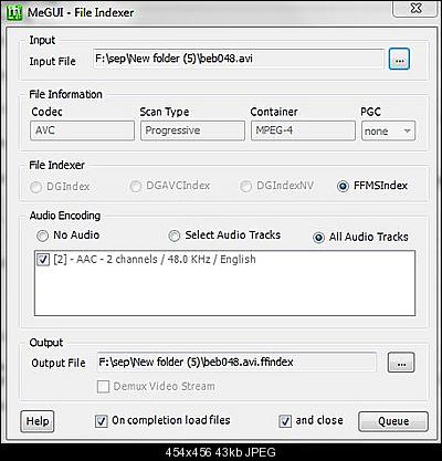

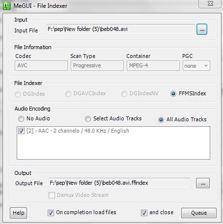

    I cant even use file indexer with meGUI....here is the problem...

    I guess because my avi file is mp4 avc format..therefore when i use meGUI create avs..it happens with directshowsource..and couldnt let me create avs file....
    so i wanna ask..are there other options for me to create avs for that mp4 avc format avi file? i heard that there is software like 'avs creator ' for us to create avs file in different source..but i couldnt find any thru google...can u find for me? thanks

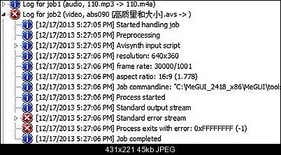

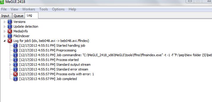

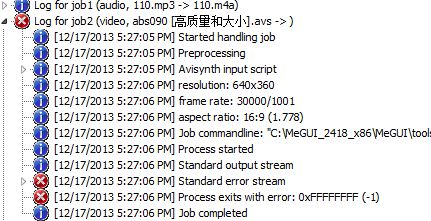

    however, when i tried to encode x264 from avi...it got new problem again...below are the pictures
ID:	22157i guess is some kind of settings problem...last time when i use 'final codec pack' it shows no issue for this encoding....

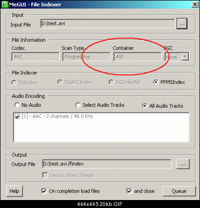

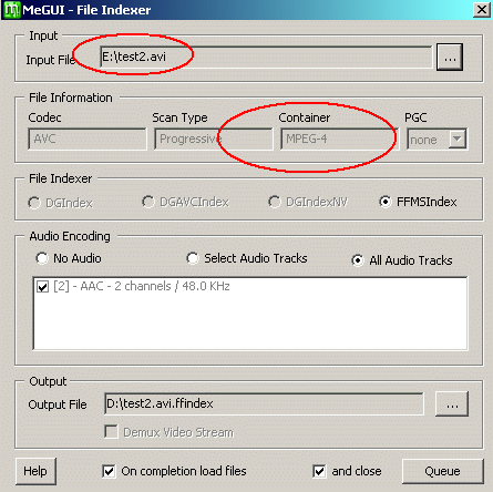

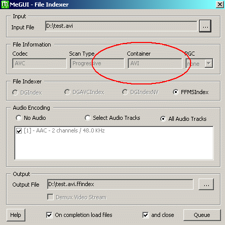

  18. The AVI in your earlier file indexer screenshot (post #15) seems odd.... AVC video with AAC audio (not out of the question, but unusual). You seem to have found the problem yourself with post #16.... in a round about way.
    In your case under File Information/Container, the file indexer says MPEG-4 even though the input video has an AVI extension. I think you have an MP4 with the wrong file extension.
    Thinking about it, that'd explain why sometimes MeGUI offers to use DirectShowSource when you open an AVI. It's not really an AVI. I strongly suspect your "beb048.avi" file is really an MP4.
    If your AVI was really an AVI, it should look like this (I created one containing AVC video and AAC audio just to be sure it wouldn't make any difference):

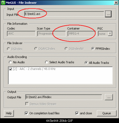

    Yep, now I'm sure that's the problem. I just took an MP4, renamed the extension as AVI and when I tried to open it via the script creator, it offered to use DirectShowSource rather than AVISource. At least MeGUI was clever enough to know it's not really an AVI, but unfortunately it failed to open. When I tried the file indexer.... same as the screenshot in your post #15 and the one below. Your AVI appears to be an MP4. Try changing the file extension to MP4 and starting again.

  19. Originally Posted by hello_hello View Post
    [Attachment 22160 - Click to enlarge]

    thanks...i tried change the file extension from .avi to .mp4..and try create avs via meGUI..and it works..
