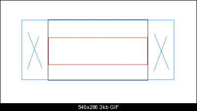

    Removing part of the video is not an easy topic to explain. Here's a rough description of what's involved. The black rectangle is your TV screen. The red one is the video you're watching. In order for it to fill the screen without being distorted or stretched, it needs to be enlarged on playback until it's the size of the blue rectangle, but your TV probably won't do that. You'd need to remove the picture marked with an "X" when re-encoding.... so what remains is the same aspect ratio as the TV screen. Most encoder GUI's will let you do it (even AutoGK) but you'd need to work out how much to remove each time as each video will be different. I don't know of any programs which will do it automatically.
    AutoGK won't stretch the picture when encoding.... by design it prevents you from doing so. It will let you remove some of it from the sides but it's probably not the easiest program to use if that's what you're wanting to do. It's not about creating a "larger" AVI as such, it's about creating an encode with 16:9 dimensions so when it's enlarged on playback it fills the entire 16:9 screen.
