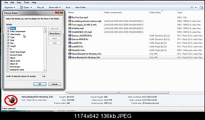

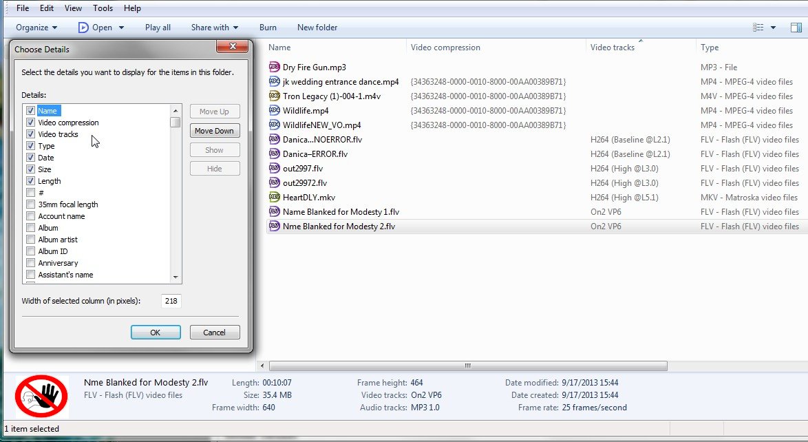

  8. Member Budman1's Avatar
    Jul 2012
    NORTHWEST ILLINOIS, USA
    Thanks a lot for everyone's response. I too needed that ability and since Xmedia displayed the codecs as a standard detail panel, I tried going to Windows 7 folder View -> Choose details and found this can be set there also. Just thought it might be good feedback for anyone perusing this thread.
    Thanks again, now I have 2 methods.
Name:	ScreenHunter_45 Dec. 12 17.59.jpg
