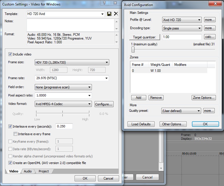

    I want to trim these .avi Xvid files without re-compressing so that I can edit them later, to save hard-drive space. The audio tab is set to PCM. My understanding is that as long as your render matches the original file's settings, any quality loss should be trivial.
    Are the settings in this screenshot acceptable for my purpose?

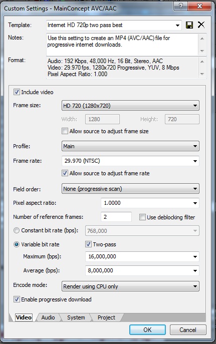

    For now, using Vegas, what is my best option of compressing down these larger Xvid files? I have been getting decent results out of MainConcept AVC/AAC (*.mp4) using these settings (video rendering quality is set to best):
    Not much to say about that other than that there is a non-trivial quality loss.

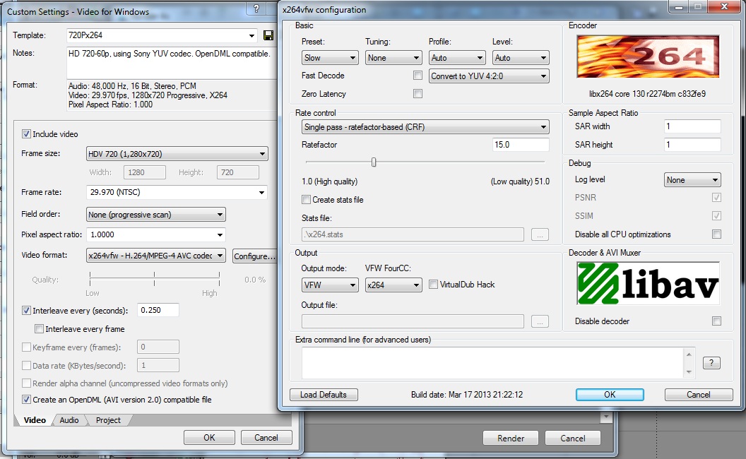

    I was interested in using x264 because I have used it in the past and it does a good job. However, when I try to render in vegas using it the output files are only giving me a black screen. I tried playing them in VLC and WMP to the same result. I know the encoder itself is working because I can record using x264; but that's no good for editing.
    Those are the settings I used. Any ideas?

    smart rendering does not work with xvid. it only works for -
    • DV AVI
    • DV MXF
    • IMX MXF (IMX 24p MXF is not supported for smart rendering)
    • HD MXF
    • MPEG-2 (for files such as those from HDV and DVD camcorders)
    • XDCAM EX
    for xvid sources only edit and render out once.

    If it's just simple cuts type editing , use vdub or avidemux. No compression losses if cut on keyframes. And if you need frame accuracy, they smart render xvid, no compression losses except a few frames around the cutsite in the affected GOP

  11. Do you have 64bit version of x264vfW in case you have 64bit Vegas?

  13. Question #1. Without smart rendering the quality loss will be significant, but you might still not be able to tell. You do have options if you don't mind anothe program first, but if you don't feel like messing with anything else you can go ahead and render it and see if it suits your needs. It is very easy to smart render xvid with virtualdub. Grab the newest version, click on full processing mode, choose xvid codec 1 pass and give it a bitrate matching the rest of the file. Click on video>smart render. Now make all the edits you like, frame acurate and file>save as will produce a new file with zero quality loss and it will take only a few seconds to do. If hoever you are going to use ANY effects or filters or anything in vegas, then this would be a pointless procedure and do it all in Vegas. But if you just want to trim the file and be finished, you will get much better results using virtualdub's smart render. It is fast and easy. You can easily goto the vdub guide for how to trim with virtualdub to learn how the trimming works, and then follow my instructions here to setup as a smart render.
