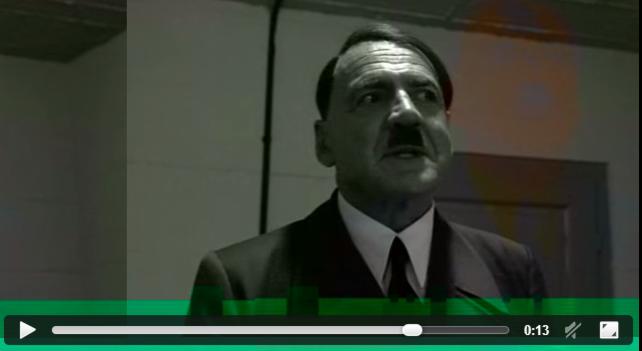

  4. Output image looks broken, like the color space got mixed up. (see attachment)

    I also attached a vp9 file created with the build, does is look okay for you? May be it's just my decoding (used MPC-HC, Chrome, ffplay).
    Must be something with vp9, since the decoder call works fine with x264:
    mencoder -lavdopts threads=8 -really-quiet -of rawvideo -o - -ovc raw -demuxer lavf -vfm ffmpeg -noskip -vf scale,format=i420 -forcedsubsonly -nosub -nosound -mc 0 "H:\TESTCL~1\test.avi"  | x264 --crf 18 --non-deterministic --fps 25000/1000 --input-res 640x352 --output "H:\Output\test.264" -

    and got the attached file, which shows the same problems for me.
    I don't know if 1 pass encoding is still stable and I don't use mencoder
    Same happens for me with ffmpeg as decoder.

    -> seems like vpxenc now only supports y4m input, despite the fact that the help only states:
                --yv12                      Input file is YV12
                --i420                      Input file is I420 (default)
    -> WTF?!?
    Thanks a lot for testing and sharing your build.
    (didn't consider testing y4m since the help doesn't mention it)
    btw. ffmpeg as decoder works fine too as long as yuv4mpegpipe is used. (using raw i420 or yv12 produces the above problems.)
    -> filed a bug report: http://code.google.com/p/webm/issues/detail?id=678
