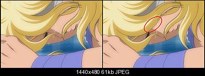

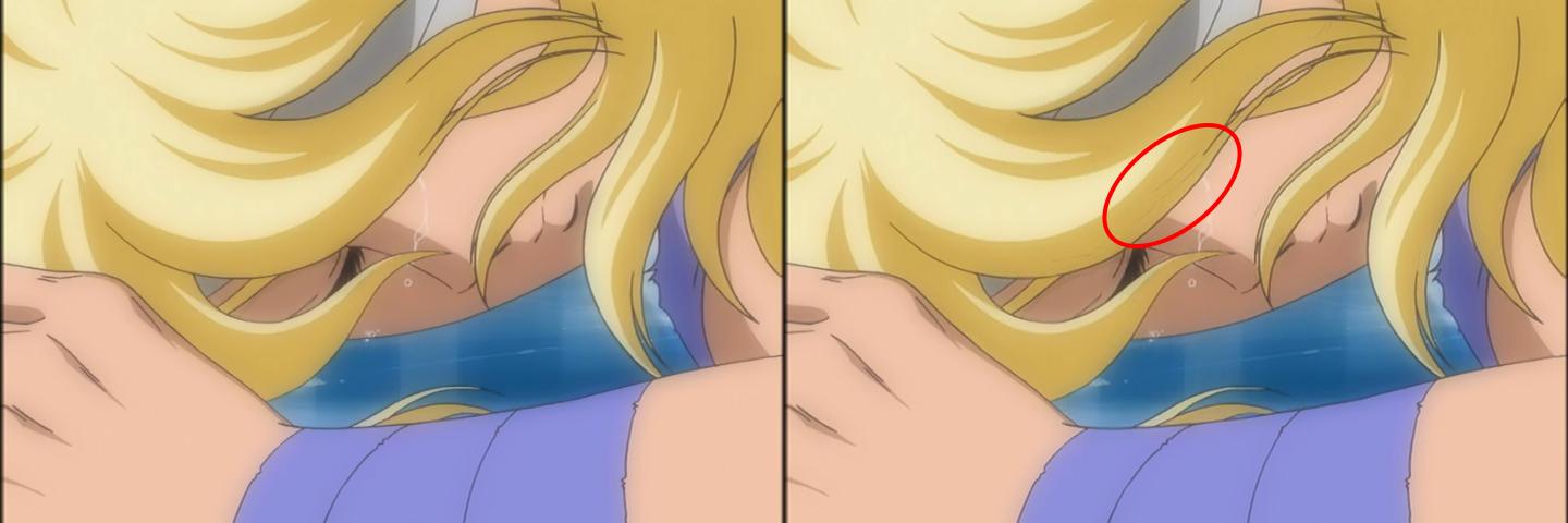

  5. The only place I saw comb artifacts after TFM().TDecimate() was in the fade-from-black at ~44 seconds into the clip. That fade-in was done on interlaced video so every field is different (although it's still normal 3:2 pulldown from the film frames).
    Since each field is slightly brighter than the last TFM() can't find a perfectly matching field -- so it uses the closest match, a slightly brighter or darker field. Adding vInverse() to my earlier script will blend away those comb artifacts:
    Mpeg2Source("VideoFile.split.2.d2v", CPU=6, Info=3)
    Interleave(TFM(field=1,pp=0), TFM(field=0,pp=0))
    vInverse()
    Removing the "pp=0" arguments usually gets rid of those residual comb artifacts, but didn't work in this case because they are too light. I try to avoid enabling pp (post processing) in TFM because it sometimes makes mistakes -- especially in animated content.
    Or you could full QTGMC():
    QTGMC(preset="fast") # or whichever preset you prefer
    The fade from black will be a little smoother with QTGMC() but it sometimes causes a little ghosting:
    On the left is Interleave(TFM(field=1,pp=0), TFM(field=0,pp=0)). On the right is QTGMC() -- you can see dark lines ghosting from the next frame. QTGMC() sometimes leads to other small distortions.

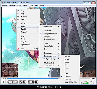

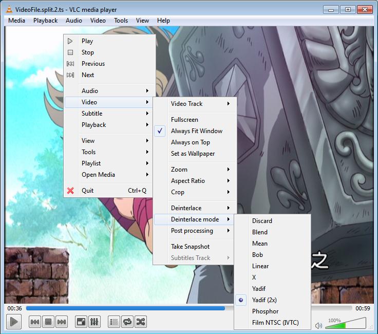

  15. Almost all players can deinterlace during playback. VLC for example:
  16. This DVD they can not, I've tried with MPC-HC, VLC, SPlayer, I set the codec for desentralaçar, but it's pointless.
    [Attachment 22058 - Click to enlarge]
    That was the first thing I did, to no avail. Must be something wrong with my PC?
