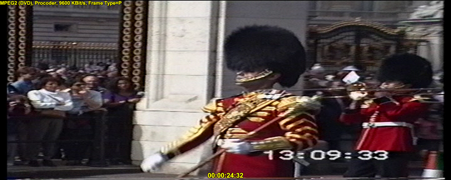

  8. Member Skiller's Avatar
    Oct 2013
    Germany

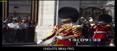

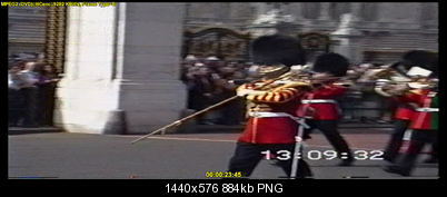

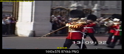

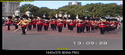

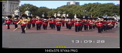

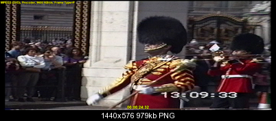

    Originally Posted by 2Bdecided View Post
    Anyone who can see any difference between DV and lossless is going to be utterly utterly horrified at DVD-compliant encoding of challenging interlaced video content, viewed with the same level of criticism.
    Speaking of it this is the best I could get out of the sample while maxing out the DVD specs at 9600 CBR (so there's still room for stereo audio). Not surprising with this particularly extreme kind of material Procoder produced the least artefacts.
    Like vaporeon800 I used SeparateFields() and LanczosResize(width*2,height*2) for these screenshots.
    I also tried HCenc and CCE SP3. I confirm, no matter what I tried, HCenc pretty much fails at this sample.
    Here's a HCenc screenshot (same frame as the 2nd one above).

  9. Member 2Bdecided's Avatar
    Nov 2007
    Thank you Skiller. It's what I've been seeing for years.
    HCenc isn't very good with high quality detailed interlaced camcorder footage either. TBH MPEG-2 itself isn't really; the "better" encoders start to throw away details and sharpness to avoid artefacts. If you're going to look closely at individual frames, you're going to be very disappointed.
    If you're going to print out screen captures to photographic paper, or upscale your VHS captures to Full HD, burn them to high-bitrate BluRay, and then press pause to look at individual frames, then maybe you'll see the advantages of lossless capture. But if your VHS captures are heading to DVD, I just can't see how you'll ever see the difference. DV is far from the weakest link in that chain.

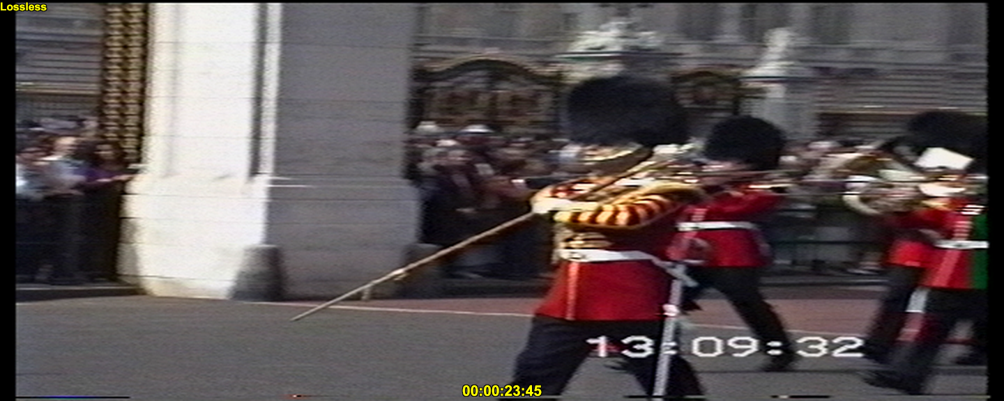

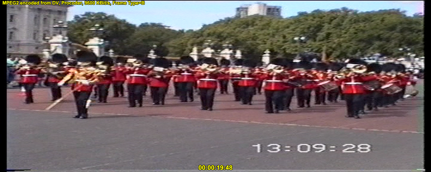

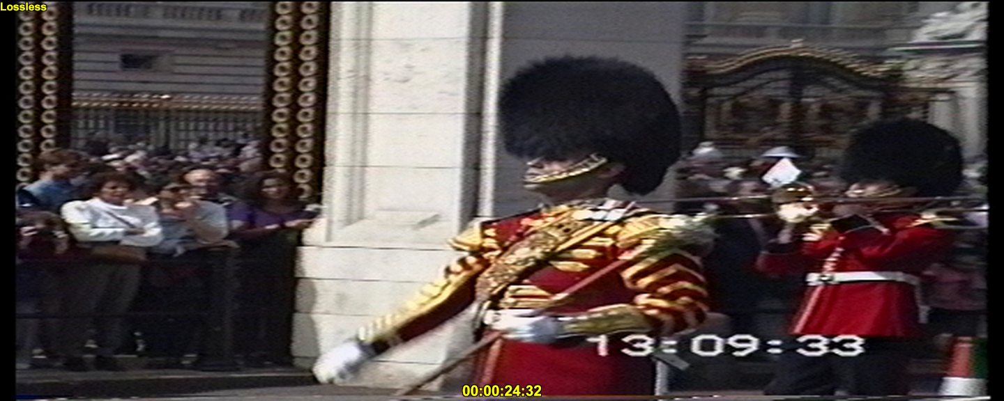

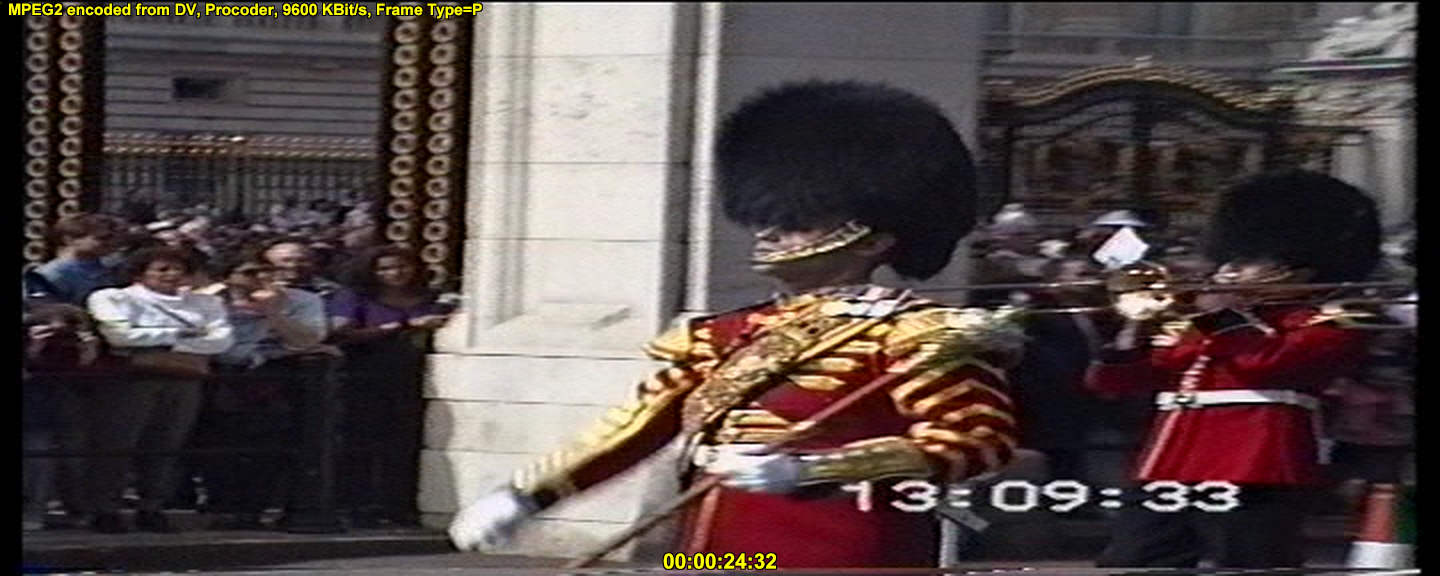

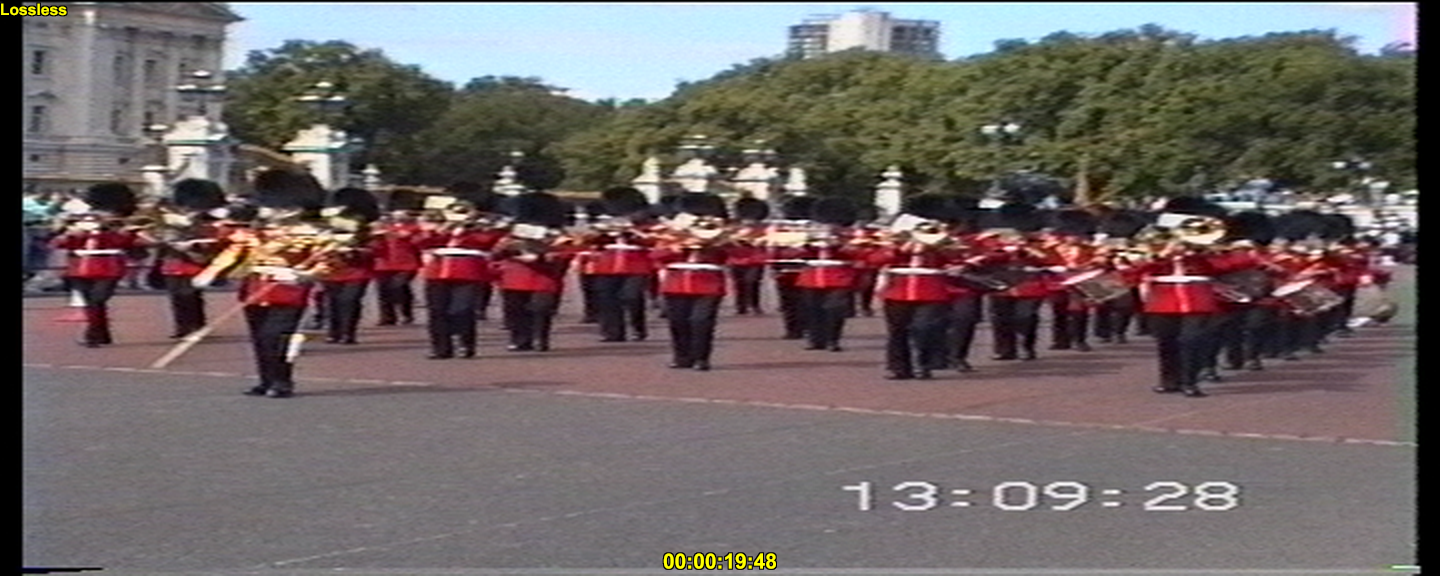

  11. Member Skiller's Avatar
    Oct 2013
    Germany
    Originally Posted by vaporeon800 View Post
    What about compounding losses from a trip through DV prior to MPEG-2?
    Good idea! Thanks for the DV sample.
    Since Procoder needs YUY2 input I requested Cedocida to decode the DV source to YUY2 via pixel_type="YUY2" in AviSource.
    Here's a roundup:
    Lossless
    MPEG2 encoded from Lossless
    DV (Cedocida)
    MPEG2 encoded from DV
    Lossless
    DV (Cedocida)
    Lossless
    DV (Cedocida)
    Now I wasn't really expecting much of any difference between the MPEG2 sample that was encoded from the lossless original and the one that went through the DV trip (except for the artefacts to "look different"). However, especially in the first set of screenshots the one that was encoded from the lossless original does exhibit quite a bit less mosquito noise – have a look at the building in the background at the top of the picture, the skyline and the building on the left.
    This made me suspicious about really using the same settings in Procoder that I used a few days ago (there aren't that many settings in Procoder anyway). So I double checked by encoding the lossless original again today using the settings I just used for the DV one... and I got bit idential output compared to what I got a few days ago, so any difference is really down to the DV encoding!
    In the second set of screenshots there is more mosquito noise around the guard's stick (sorry, don't know what's it called).
    In the third set there is blocking in the DV sample that made it perfectly all the way into the MPEG2 encoding of it and is barely there in the losslessly sourced MPEG2 encode! Look at the gate in the top right corner.
    So, there's a difference, even when encoding for DVD. I'm surprised. But let's put it into perspective: we are looking through the magnifying glass at a single field we would normally see for 0.02 seconds. Also, this is a very very hard to encode video, the differences may be amplified because of that, or maybe not. Something else to test.

  13. Member 2Bdecided's Avatar
    Nov 2007
    Aren't most of us watching on 1080p screens even if we burn to DVD specs?
    I was thinking the way to actually see a difference is to capture to lossless, upscale, and then encode to BluRay specs. I was thinking this could be (slightly) visibly better than capturing to DV, upscaling, and encoding to BluRay specs.
    I was thinking that the DVD encoding stage would hide the difference. However, I'm willing to admit I was wrong. The first comparison in Skiller's post shows some of the mosquito noise from the DV encoding making it through to the MPEG B-frame.
    In the second comparison, there's blocking on the guard's arm in the MPEG-2-from-DV encode that's absent in the MPEG-2-from-lossless encode. This is especially strange because that blocking isn't visible in the DV version, but obviously something else in the DV version is upsetting the MPEG-2 encoding - probably the increased noise overall.
    I'd rather watch the DV version than the MPEG-2-from-lossless version (the damage done by MPEG-2 encoding on B-frames is much larger than the damage done by DV encoding), but if you have to create a DVD, this example shows it can be visibly better to create it from lossless than DV.
    I've seen this effect with high quality sources, but this is the first time someone has proven it with a VHS source. Thank you Skiller. In thinking this couldn't matter, I was wrong!
    I have to admit though, even when I know what to look for, I can't see the difference when I'm watching the video normally.
