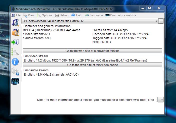

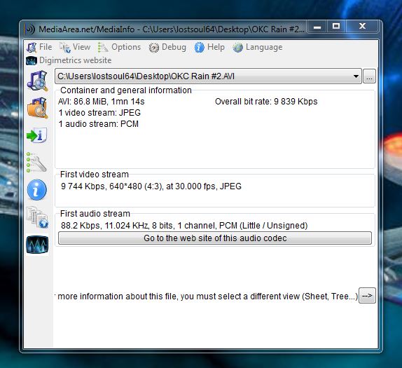

  10. I'm going to try and upload a AVI and MOV file from mediainfo. Sorry I downloaded the wrong file last time. Thank you for helping me.

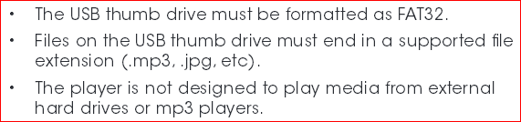

    Unless you posted the wrong model number of your television. It doesn't support any videos. It only plays mp3's and jpeg's, that's it. (page 42 -44) So to quote Cornucopia rtfm. http://store.vizio.com/documents/downloads/hdtv/M3D550KD/UM_M3D550KD.pdf
  12. If you take a look at page 7 it will tell you that it does play video. I have a S100 Nikon camera and I take videos (.MOV) and it plays and sounds great on my TV with my flash drive on my USB port. It also plays MPG but I want it to play WMV and AVI though a converter. I'm new at this so can you help.

    I stand corrected. On page 7 it does say it plays video. Unfortunately with no mention of format or codecs. It literally just says video. I guess when writing a manual they were to lazy to list that information. If I was you I would bug the hell out of Vizio until they tell you what videos that television supports. As listed in the manual for file extensions. The file must end in a supported file extension. And then they just list mp3, jpg, etc. That my friend is ******* lame. They couldn't just list the extensions? "Etc"? What a joke.

  18. lostsoul65, I posted my reply before the details of your bad AVI file appeared in my browser. While my advice still stands, and I think you will get much more success using the separate media player, I do agree with what others have said after seeing the specs of your file: it is very strangely put together. AVI files don't typically contain JPEG video + PCM audio. Since you seem able to play it on your PC, there's a very good chance it will also play on an outboard media player, but it might not. In that case you would need to convert it into a more standard format, which is not always an easy task with such weird files.
    External media players like the ones I suggested are very forgiving of screwed-up files, and will generally play them OK. But when they can't play them, its a good indication that the file is a hot mess that would be very difficult to convert or fix. Such files should be set aside for playback only in your PC.

    lAVI files don't typically contain JPEG video + PCM audio.
    They also don't have audio with a sampling rate of 11 kHz. That must sound awful! I would not be surprised for any media player device, including a TV, to have major problems with that video codec and audio sampling rate.

  22. From the manual, your S100 camera files are MOV (video: H.264/MPEG-4 AVC, audio: AAC stereo). Use mediainfo on a working file to ascertain video and audio bitrate. You can convert your avis to match.
