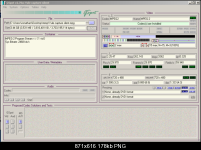

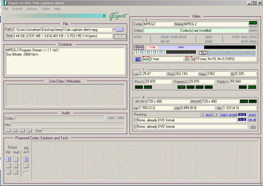

    Mediainfo says it's 2 105 Kbps, gspot says it's 2468 kb/s, but then it also says its 3362 kbps.

    But mediainfo is referring to different things, such as maxmium bitrate and average bitrate. It's not necessarily accurate anyway - it just scans the header, doesn't parse the file. gspot actually parses the file, so is more accurate for bitrate determination

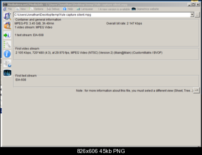

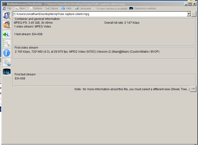

ID:	21773Click image for larger version
    Here's some more info

    mediainfo view=>text shows more info, but you have a custom matrix ; I can tell you right now that usually prevents vegas from smart rendering
