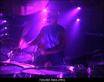

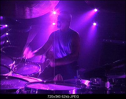

    yours:
    mine:

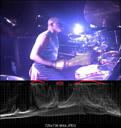

    There's a problem with your capture too. You encoded with Lagarith as RGB, not YUY2. That has resulted in a loss of detail in the brightest parts of the picture. I recommend you go back and capture again as YUY2. And try using the capture device's proc amp controls to bring the brights down a bit. The areas marked in red are where peaks where probably crushed because of the YUV to RGB conversion:
