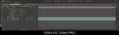

    Mar 2013
    UK
    Peed is right that you should check the interpolation curve and set all to SMOOTH, or whatever is the finest increment. Ideally TWO keyframes ONLY, set to smooth, is ideal.
    How do I sort this? When I set it to to two keyframes, one at 0:00 and one at 3:00, it goes really slowly until the end.
  20. It appears you've managed to insert an extra keyframe into each of your clips with some sort of bezier interpolation.
    I would suggest you go the route of stacking your layers in a single, spatially static, image and then using a camera layer to zoom all the way through. Linear interpolation of keyframes is the easiest way to set up your moves and then you can add bezier and additional keyframes as you see fit.
    Mar 2013
    UK
    All over my head! This is how it's set up, it's the complete pre-comp with the keyframing on top, so that isn't affecting each layer is it, just the entire thing, aka a static image?
    http://s8.postimg.org/c60do63vp/Keyframing.png
  22. Originally Posted by PCC View Post
    No need to use multiple keyframes then. Just a start and end.

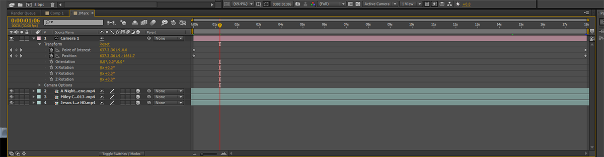

  24. Originally Posted by PCC View Post
    it seems to go really slow until the last 20 seconds where it zooms through it.
    Then try what I suggested in #141 with a camera. Here's a sample (took all of 3 minutes, but I didn't use masks):
    http://www.youtube.com/watch?v=Oeaka8GhHGo&feature=youtu.be
  25. Member
    Mar 2013
    UK
    Ok, what are the values affecting there? Scale?
  26. Member
    Mar 2013
    UK
    I've put a camera layer into the pre-comp, just as the first layer, will that have the same effect?
  27. Originally Posted by PCC View Post
    Yes. As long as 3d is enabled, the camera can actually be any layer.
    edit: By cycling through the camera tool "c" you can manually manipulate zoom, position and rotaion.
  28. Member
    Mar 2013
    UK
    Ok, how can I see how changes to the camera are effecting the rest of the comp?
  29. Originally Posted by PCC View Post
    If you've got the 3d cube on for each layer, and the camera layer placed somewhere in the comp, and you're using "c" to cycle through your camera options, and you move your mouse -- it should show up on the screen.
