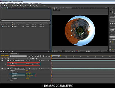

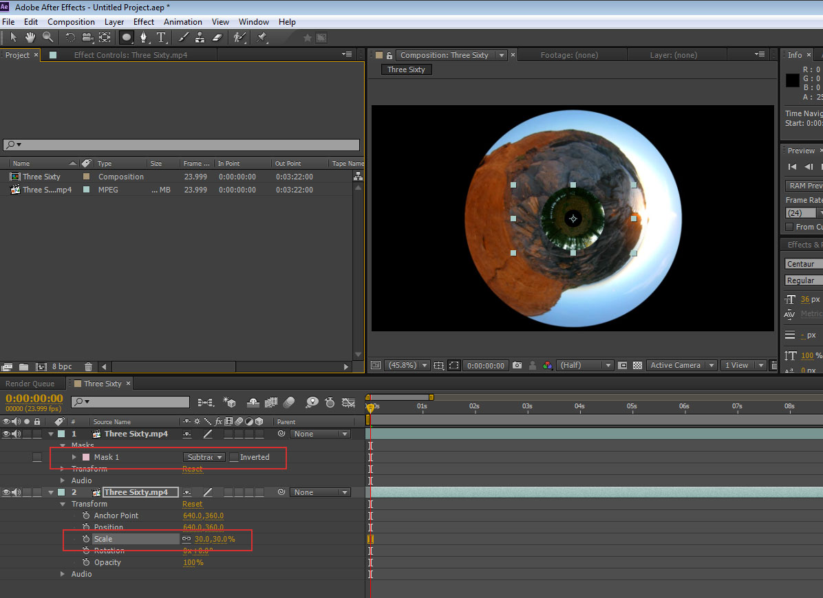

  7. Originally Posted by PCC View Post
    Thanks for the help guys. I now have the 6 layers in AE like this: http://s22.postimg.org/ugp7w5lwh/image.png
    They should be stacked and scaled, like this:
    [Attachment 21783 - Click to enlarge]
    Ok, but I want to have it zooming out. So it starts in the centre of that, and then the layers creep in from the corners.
