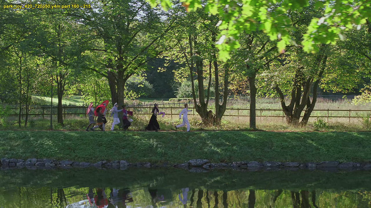

  1. x264 rev 2345
    x265 rev 0.6+89-55d99b6651f2 (UTC 11:21:27 AM) from https://x265.cc/
    Sample: park_joy_1080p50.y4m (http://media.xiph.org/video/derf/)
    x264 --preset veryslow --crf 32.4
    https://mega.co.nz/#!9Z9C0JLZ!Y7GcCgWMehUgezvJhXb_qX6FIKRYrp2AEhxsm6s-6xQ
    AVERAGE BITRATE: 6757 kbps
    x265 --preset medium --crf 28 (default value) --fps 50
    https://mega.co.nz/#!wE0SyRhA!RcDCBnXnEwvZCxbDymM9FxIzwCZ36Qs14vt3Rqrviyg
    AVERAGE BITRATE: 6821 kbps
    Use latest mpc-hc to play raw .265 files
    Encoding time on Q6600@3Ghz
    x264 : 2m:45s
    x265 : 10m:03s
    Screenshots
    x264 -> http://s17.postimg.org/4r8nvo0wv/park_joy_1080p50_mkv_160.png
    x265 -> http://s17.postimg.org/cy0nn8qzj/park_joy_1080p50_265_160.png

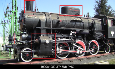

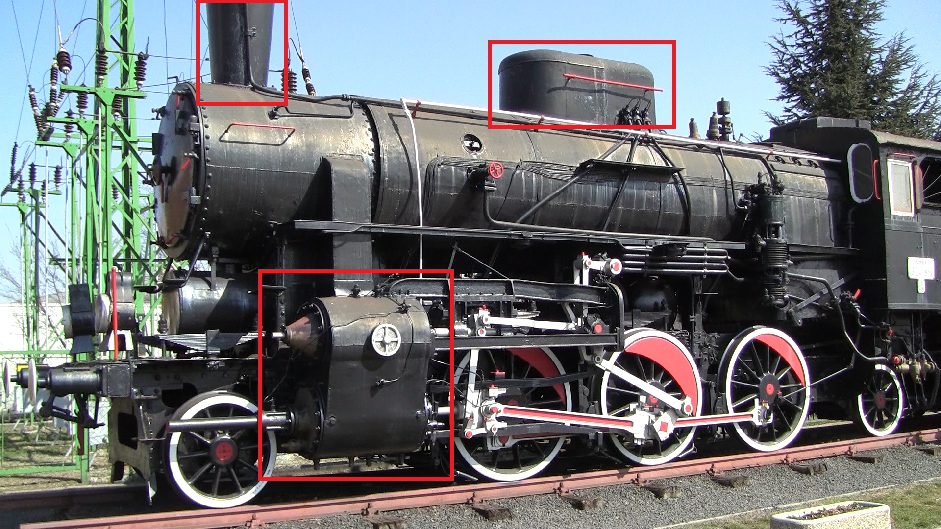

    As you can see, the Snajperas's h264 video was worse, (enormous trembling rude hyper-block pixels on the homogenous surface of the engine.)
    Especially on the marked surfaces on the engine. Just compare his x264 videos, and my x265 version.

  9. Originally Posted by Stears555 View Post
    [Attachment 21821 - Click to enlarge]
    Ok I see You are just a 12 year old troll
    I'm 33 years old.
    The photo was taken from the original mts file.

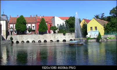

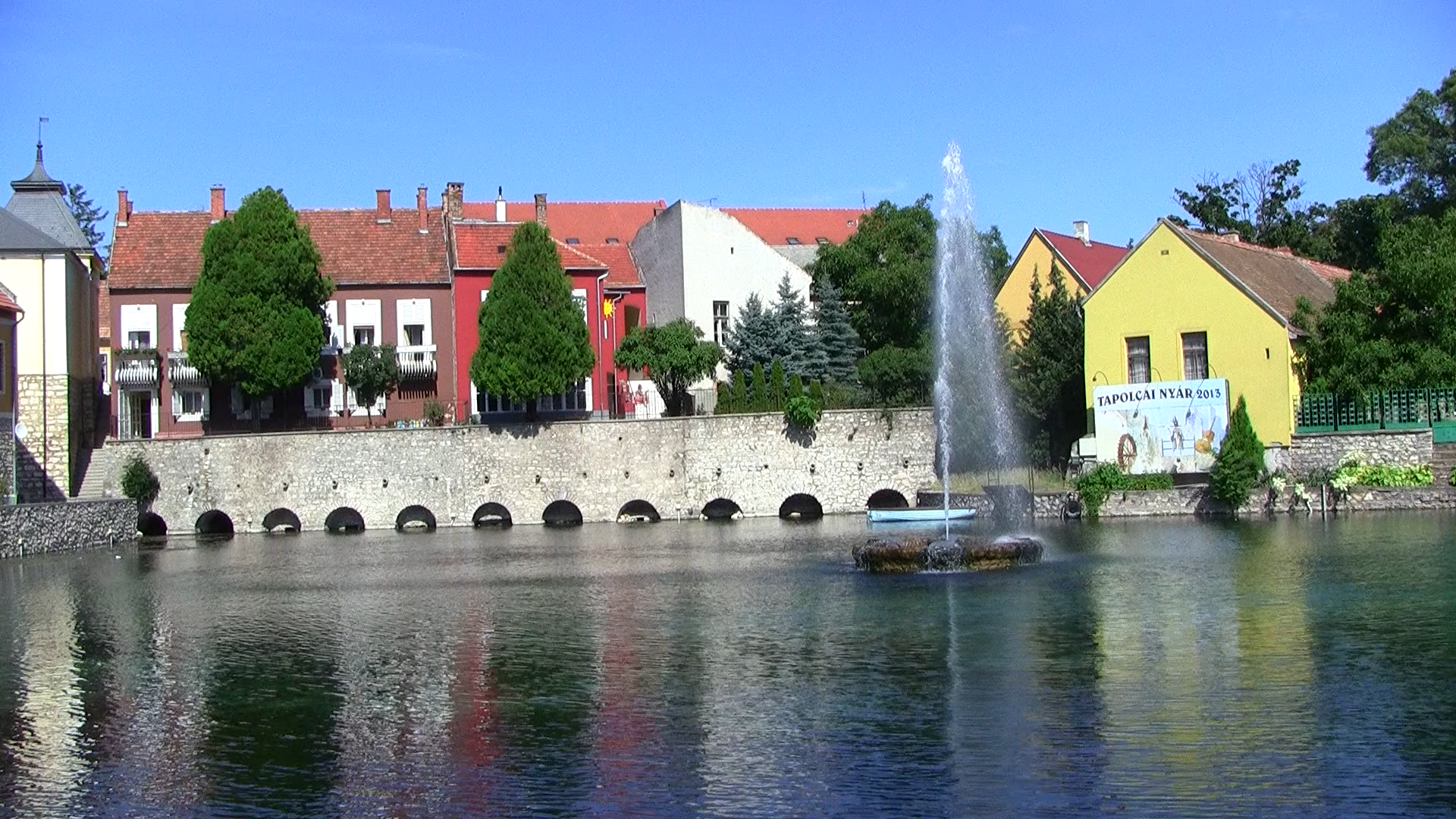

    A snapshot from the fountain

    i suspect either a player/decoder issue for both those earlier x264 / x265 png's postings, or 0.6+89 build is borked for { --preset medium } unless you added other params not mentioned in those.
    i received different results than the ones originally posted on page 1 or 2.
    i used {x265 0.6+86 build } { --preset ultrafast --crf 17 } and encoded the clip. the results of that is represented below.
    edit 1: wups, i copy/pasted/uploaded the sample clips from the posts. be right back with the correct ones.
    edit 2: here is the correct sample.

    i updated the sample in the previous post, sorry about the confusion. the correct version is now available in above post.

  30. Originally Posted by vhelp View Post
    Sorry mate but you made two serious mistakes!
    According to screenshot you used 720p version (http://media.xiph.org/video/derf/y4m/park_joy_420_720p50.y4m) not 1080! (http://media.xiph.org/video/derf/y4m/park_joy_1080p50.y4m)
    Another mistake is that you have lowered CRF value (--crf 17)!!! This means that encoder can spend more bits ! Higher bitrate means higher quality and FILE SIZE!
    LOOK at my test with AQ on and with latest build . Remember bitrate/file size MUST be more or less the same!
    x265 rev 0.6+110-c6c73ef24c97 (UTC 6:50:54 PM)
    x265 --preset medium --crf 28 (default value) --fps 50 --aq-mode 1 --aq-strength 1
    https://mega.co.nz/#!VAFWzKKZ!EbXieQMnf1T6OpDAMfIMYQzU-O9kMEKP02sRcRC-zww
    AVERAGE BITRATE: 5390 kbps
    x264 --preset veryslow --crf 33.75
    https://mega.co.nz/#!5MUzFIII!MmvljggQTpKTUKjzzOT7t184WI9RLFTeqXPPYpf HO8w
    AVERAGE BITRATE: 5381 kbps
    Screenshots for lazy people
    x264 -> http://i.cubeupload.com/de2PZl.png
    x265 -> http://i.cubeupload.com/pvx9Jh.png
