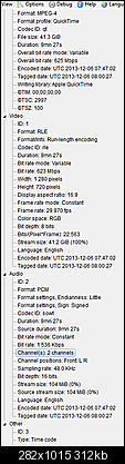

  4. Hi,

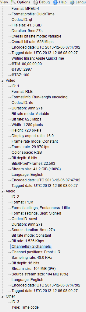

    Yes, the original Qt movie file is fine. It's happening with the encoding process. I just don't know what to use as settings. I even tried adobe media encoder. So I am setting something wrong. I used mediainfo and here is what it said about the original file:

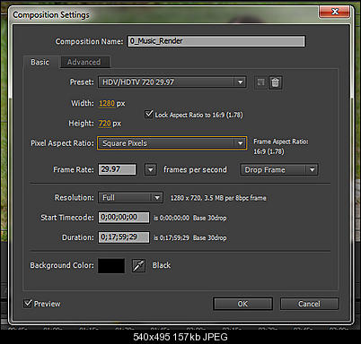

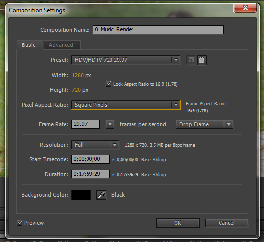

    My composition settings in after effects are as follows:

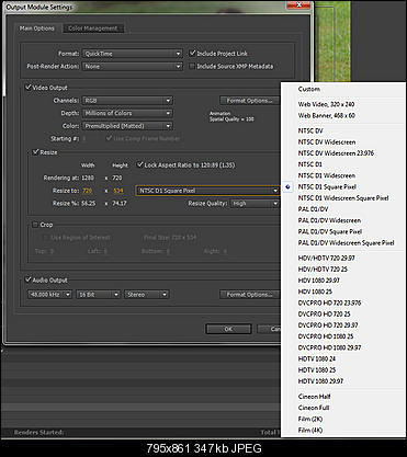

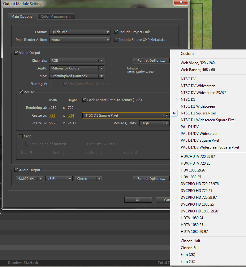

    If I render from after effects as SD, what should I select below for NTSC?:

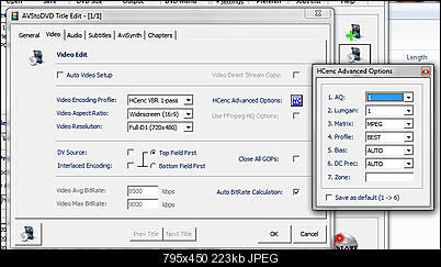

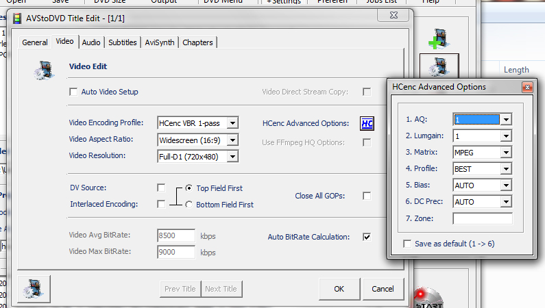

    I am in the process now of trying Avstodvd. If you when to see any red flags, please let me know. Thank you.
  5. for NTSC DVD you need to choose NTSC widescreen mode

    Video bit rate of 623 Mb/s?

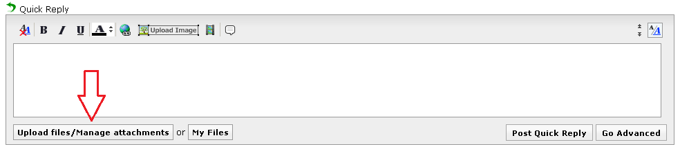

  10. So how do i attach the vob for you to see? thanks.

  16. Hi,
    Ok, can you just check this file? I believe using HCEnc VBR 1-pass solved it... I notice a little flicker now and then but it is very, very minor. Would you suggest lowering the bitRate? Right now it is on AUTO Calculate. Here are the settings.
    Thank you sooooo much - I have been looking for a solution for almost a week.
  17. Here is the log.
  18. Originally Posted by Mnesnay View Post
    Hi,
    It's actually not hitting the intended bitrate target (your sample is <6Mb/s)
    Lowering the bitrate won't help improve it. Using 2pass VBR instead of 1pass might help improve it some more, and a different matrix might help it to use more bitrate
  19. This is with it as a 2pass VBR.

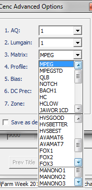

  20. These are the choices for matrix. Would you suggest MPEGSTD? Or something else? Thanks.Name:  matrixChoices.jpg
  21. FOX1 will definitely result in higher bitrates but I don't know if it's a optimal choice in this scenario.
    manono might have a better suggestion, he even has some matrices named after him (look in the screenshot) . You can try PM ing him if he doesn't reply
    https://forum.videohelp.com/members/54890-manono
    For pure slideshow content , high bitrate CBR encoding might be a good approach as well
    2pass VBR becomes more important when you have different types of content, bitrate is allocated more ideally
  22. Most of the matrices HCEnc uses aren't even for DVD but were developed for use with XviD encodes. The only pure DVD matrices are the MPEG, the MPEG STANDARD, the three FOXes and the three MANONOs. I'd go with FOX1 as it's the best of the bunch and I think its use won't result in too high of a Q factor, considering how static a slideshow is. The only parts using a lot of bits are the dissolves.
    If you don't care about the file size, you could do a single-pass Constant Quantization encode. But I don't know what its numbers mean as they're different from those in CCE. Maybe try with the default 5. And I'd raise the max bitrate to 9500 as your audio is only 192 and HCEnc promises not to go over the max bitrate set.
    And I also agree with pdr that a high-bitrate CBR encoding might be useful for this kind of material. Does HCEnc even do CBR encodes? Anyway, you could set both the minimum and average bitrates higher to better approximate a CBR encode.
    But it's a pretty good-looking encode already, much better than the first one.

  27. Hi,
    I think FOX1 worked - I burned it on a dvd and played it. Looks a thousand times better than my original try. Thank you all so much for your help. I learned a lot in a very short span of time. Thanks again.
