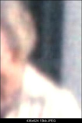

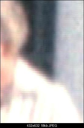

    The problems are the fields are in the wrong position -- the lower field is above the upper field. Use the Field Swap filter in VirtualDub, or the SwapFields() filter in AviSynth, and all the comb artifacts go away.
    4x Point enlargement, before:
    and after SwapFields():
