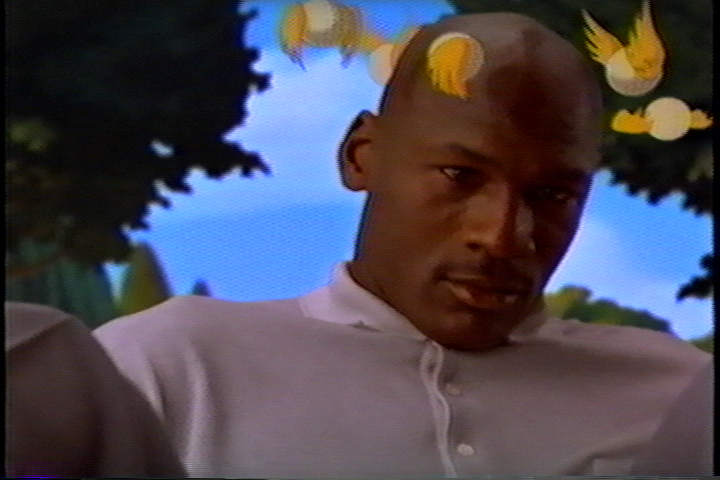

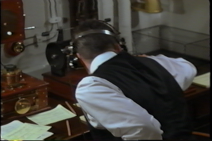

  11. Formerly 'vaporeon800' Brad's Avatar
    Apr 2001
    Vancouver, Canada
    Originally Posted by mrsark87 View Post
    I wanted to mention that I also have a Sony VCR, SLV N500.
    This model is from 2003, which I think most here would say was past the heyday of VCRs. I had the opportunity to use one briefly and found that it added nasty processing to the picture. I just went though the manual and I don't see any option listed to disable it.
    I'm not sure whether Mr. Jordon's face is supposed to look like plastic in Space Jam, but I do know how ugly Titanic looked playing on it.
ID:	21729 vs. Click image for larger version

  13. Banned
    New York, US
    No, it's not supposed to look that way. I noticed the posterization effects on several of the last of the SONY vcr line from 2001 and later, which seemed to get worse by the time SONY VCR's disappared from store shelves. I saw that with acquaintances who used those machines, and on a lark I bought one on sale to replace my father-in-law's dead RCA. I was pretty shocked by the effects, returned the machine, and ended up with a surprisingly decent 1998 Panasonic off eBay (the darn thing looked new. I don't think it was ever used).
    I wouldn't be surprised if SONY had nothing to do with manufacturing those units other than putting SONY logos on them.

    If you look at the captions below vaporeon800's sample images above, you'll see he compared your Sony to a Panasonic AG1970, and the AG1970 looks quite a bit nicer. If you try a JVC 9000 or DVHS, and it doesn't work out for you, the next best thing would be a Panasonic AG1970. This is an earlier variation of the AG1980 that is much more reliable and a lot cheaper (easily found for $50-$100 depending on seller and condition). The AG1970 does NOT have the desirable TBC/DNR feature of the AG1980 or JVCs, but it is a well-built semi-pro vcr with very decent basic picture quality and several controls to let you customize PQ. It does have a mild version of TBC which is often more compatible with 2nd-generation camcorder copies than the full-strength TBC in the AG1980, JVCs, and Mitsubishi. I find I keep returning to the AG1970 for most of my digital dubbing work.
