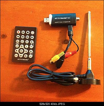

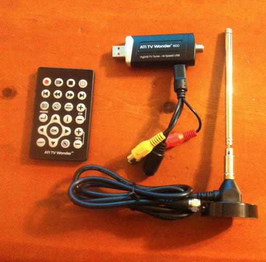

  13. Originally Posted by usually_quiet View Post
    This device? http://www.amazon.com/ATI-Wonder-600-USB-Tuner/dp/B00138EOH8/
    So it can take composite and s-video input?
    The link is the right device and it CAN take composite and S-video with the capture accessory cable that should be provided with the complete product. I should know since I have a TV Wonder HD 600 USB.
    The description at Amazon says it accepts composite and s-video input but the picture only shows an RG connector. So I wasn't sure if the description was right.
    Ah, here we go. This post at ebay shows the pigtail adapter plugged into the side:
    http://www.ebay.com/itm/ATI-TV-Wonder-600-USB-Hybrid-HD-Tuner-/251393931106
    In case the ebay image disappears, here's a small version of the picture as a reference:

    Originally Posted by vaporeon800 View Post
    I'm curious why you prefer it to the Hauppauge USB-Live2, if you wouldn't mind explaining.
    I'm assuming you're talking to Tafflad here. My favorite is the 600.
    @Tafflad: I say that if you don't want to go through the used or bidding or reseller song and dance, just get a Hauppauge USB-Live2 or an (authentic) ezcap.tv. I underline the word authentic to avoid the fake trash around the 'Net impersonating it.
    You can get the authentic ezcap.tv here:
    http://www.ezcap.tv/
    Both too, the USB-Live2 and (authentic) ezcap.tv are also excellent USB capture products.
    Ok, you guys twisted my arm. I will do a test of all three, the USB-Live2, the authentic ezcap.tv and the 600 USB cap sticks, coming to a thread near you. Just gimme a couple of weeks since I'm working like crazy this month.
    Nope; wondering why you go for the ATI 600 USB over the Hauppauge.
    Any chance you could use the same test patterns as the thread I'm working on if I share a small DVD file?
    Don't one of those suggested devices have that capability?
    If there is a USB stick that straightens out wavy lines, I'd love to hear about it.
    Ahh, Ok.
    Prominently, it's taste. Under the same hw/sw settings I find more detail with the 600. Blades of grass, hair strands, etc, show more, especially with higher quality caps like from analog Tv. The Hauppauge USB-Live2 tends to be cleaner video, but more smooth. Unless I'm doing something wrong, you can set its internal proc amp to the highest sharpness, it still doesn't reclaim those missing details (that are real, not grain).
    This is preference, like I mentioned. Still recommend the Live2 as a good choice.
    As for audio, the 600 also sounds better (although I'm not an audiophile). However, this is all moot since I capture directly through a mixer, and directly to the sound card anyway (which sounds nicer to me than any capture device's abilities).
    Would love to participate, and would love to create another thread too to show the Forum. We could arrange something after the next couple of weeks since I'm swamped at work and will be out of town, but is sounds like fun.
    Last edited by PuzZLeR; 5th Dec 2013 at 15:14. Reason: Edits only for better grammar.
