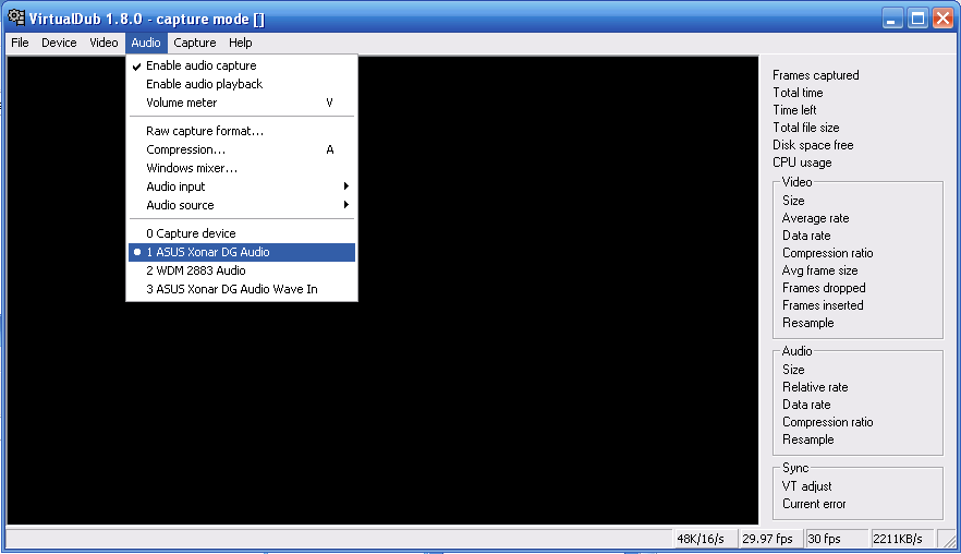

    As well, the ezcap.tv is not the greatest at audio capture (in fact, most others aren't either). But that's not a problem - I recommend you capture your audio, separately, through your sound card, such as with an RCA/composite-to-3.5mm cable from the audio-out of your VCR. Your onboard sound card should be sufficient, even if your tapes have SQPB audio. You will get optimal results with the "line in" at 48KHz, 16bit, stereo, uncompressed PCM wave.
    VirtualDub allows you to use your sound card, and these settings.

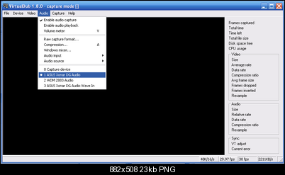

    I too have an Asus Xonar. I leave it up to you, but if you don't like the sound coming from your eazycap.tv, you at least have an alternative using your "line in" port. Perfect sync every time for me.
Name:	VirtualDub Audio.png

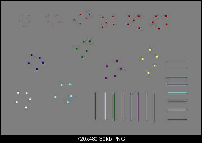

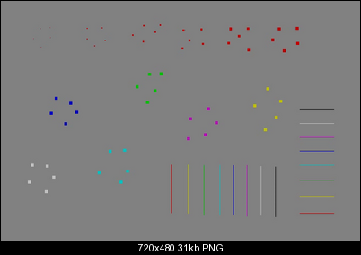

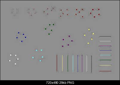

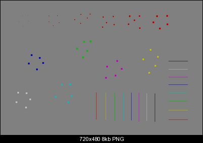

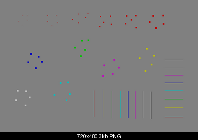

  18. I captured some screens in virtualdub at 400% magnification.
    I can't spot ANY difference between the original and the one compressed with xvid Target Quantizer 1 (which is half the size of lagarith).TQ 2 seems to apply some light denoising but it's still quite perfect (considering it's half the size of TQ 1)
    http://www.ilculto.it/cesare/images/test_original.png
    http://www.ilculto.it/cesare/images/test_xvid_motionsearch-off_tq1.png
    http://www.ilculto.it/cesare/images/test_xvid_motionsearch-off_tq2.png
    OCZ SXS2 700W - MSI Z77A-G45 - Intel Core i5 3570K @4500 MHz - G.Skill Sniper F3 1866MHz 2x4GB - SLI 2x Nvidia GTX660 2GB - OCZ Vertex4 128GB - Seagate ES 750GB - LG TV 32LH3000

  23. Originally Posted by PuzZLeR View Post
    I never tested Xvid capture with only I-frames. I do notice many artifacts, even with high bitrates, but would be curious if many will still exist with key frames enforced every 1.
    You will still get DCT ringing artifacts (all DCT based codecs will produce this) and 4:2:0 chroma blur (if your source isn't 4:2:0 already).
    RGB 4:4:4 source:
    RGB 4:4:4 video encoded with Xvid all I frames:
    Contrast stretched to bring out the DCT ringing:
    Be sure to view the images at full size with 1:1 pixel mapping.
    Of course, the DCT ringing isn't as obvious with real world video capture because you don't have sharp edges and flat shading like in the above images. And all the noise in analog caps helps hide artifacts. But you should know what you're getting into and what to look for.

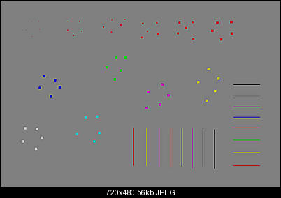

  25. Interesting test image Jagabo, I tried to compress it in Jpeg (the best known DCT-based image compression algorithm) at maximum quality 12 and it's perfectly identical to the original, no ringing artifacts.
    I then created a 1 second long video with avisynth from the PNG image and then compressed it in virtualdub with lagarith in RGB, YUY2 and YV12, and then compressed with xvid TQ=1 YV12 (the only color space available).
    LAGARITH RGB
    http://www.ilculto.it/cesare/images/encoding_tests/rgb444.rgb.lagarith.avi
    LAGARITH YUY2
    http://www.ilculto.it/cesare/images/encoding_tests/rgb444.yuy2.lagarith.avi
    LAGARITH YV12
    http://www.ilculto.it/cesare/images/encoding_tests/rgb444.yv12.lagarith.avi
    XVID YV12
    http://www.ilculto.it/cesare/images/encoding_tests/rgb444.yv12.xvid.avi
    In the xvid video there are no ringing artifacts, but there are chroma subsampling compression artifacts, just like the lagarith YV12 version.
    All in all, since my capture card already works in YUY2 colorspace and my signal is composite, the YV12 compression of xvid doesn't make any harm to the video, and the Target Quantizer set to 1 causes no ringing artifacts
    PS
    it's interesting to note that, in this specific case where all the frames of the video are identical, the lagarith version is waaaaay smaller than the xvid, because it uses motion analysis algorithms, while xvid does't because I disabled motion search
  26. Originally Posted by crespo80 View Post
    Yes there are. If you look closely you can see them. Increase the contrast and they'll really show up. Your Xvid image with contrast stretch:
    it's interesting to note that the lagarith video is waaaaay smaller than the xvid, because it uses motion analysis algorithms
    No. Lagarith has no motion analysis. But it recognizes when a frame is identical to the last and encodes it as a "null frame" which takes almost no bitrate. Also, flat, computer generated graphics compress much better with entropy encoders than with DCT encoders.
