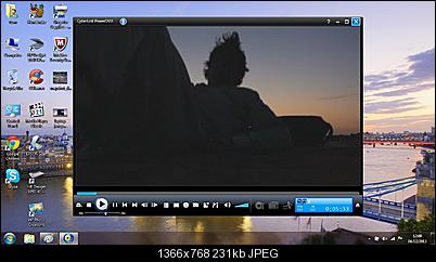

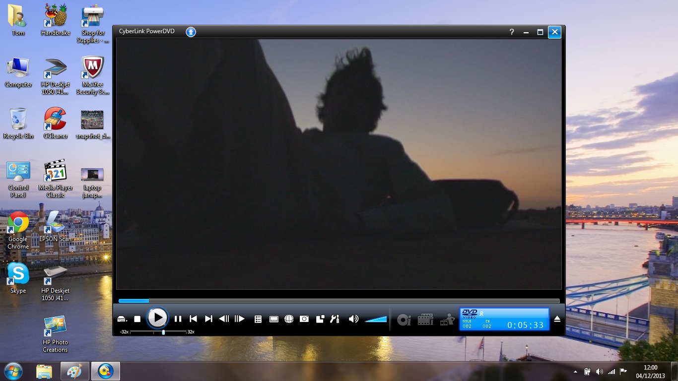

    Apologies that my first post is a request for help, but I've got a thousand copies of a newly released DVD next to me... and boy do they have problems.
    These DVDs contain a feature film, some extra features, and all the usual titles and menus. They appear to work fine on standalone DVD/BluRay players (including my 15 year old DVD player), and on certain PC playback software, e.g. Cyberlink PowerDVD:
Name:	cyberlink powerdvd.jpg

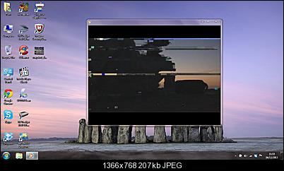

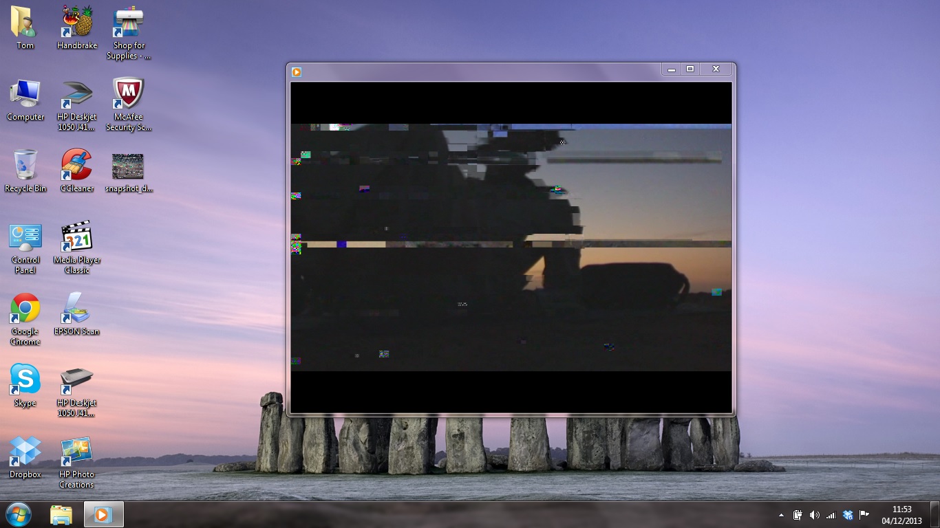

    However, when I load up other software and play the feature, all hell breaks loose with the video. Here's Windows Media Player 9:
Name:	windows media player.jpg

    I've tried this on a couple of PCs. Same result. All my other DVDs play perfectly - it's just the thousand copies of this one that don't!
    Here's the strange part... the glitches only appear in the title menu and main feature. They start in the feature after about 1'30" of playback and grow increasingly bad. The audio is fine. And the bonus features play absolutely fine too!
    So I'm stumped, and would love to hear your expert theories on what's happened here so I can call up the authoring/replication house and ask why they've just sent me 1,000 expensive drinks coasters...

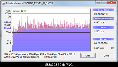

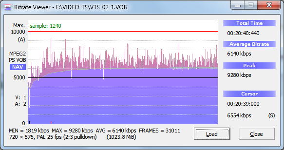

  8. Some more info that might help, this is from MPEGValidator and Bitrate Analyser on the same VOB file:

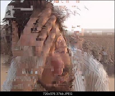

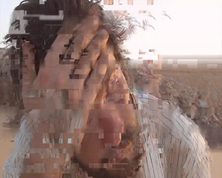

  17. I see. I'll make a bigger sample as the errors kick in just after 1:30.
    Let's forget K-Lite. I've just discovered the following with VLC:
    1. Playing the DVD disc with Win7 / VLC / no K-Lite: WORKING
    2. Copying the DVD same disc's contents to the PC, then attempting to play the VIDEO_TS folder as a DVD with the same software (Win7 / VLC): NOT WORKING. (i.e. the same visual glitches as in the OP.)
    What does this mean? Is this some kind of copy protection at work, which VLC can handle on an optical drive but MPC / WMP / direct copy cannot?
  18. Here's a 100MB VOB sample.
    I get errors playing this in WMP, MPC-HC and VLC. (The same disc played off the optical drive of the same PC in VLC works fine.)

    I downloaded the 99mb VOB and I do see some corruption that starts at around 1.30. Perhaps the file is damaged?
  22. The video starts out with nice, regular 12 frame GOPs with 2 consecutive b-frames. But after a while switches to irregularly sized GOPs with up to 5 consecutive b-frames. GSpot also shows "temporal sequence discontinuities. The problems start around 90 seconds into the video.
  23. Member
    Mar 2008
    Perhaps the result of undefeated copy protection on the original DVD?

    Doubtful.
  25. This sounds like what we're seeing. Any idea why it'd be? What does 'undefeated copy protection' mean?
  26. Member
    Mar 2008
    This means you ripped a commercial DVD, which had some level of copy protection.
    What ever program was used, the attempt to remove the protection messed up.
    This is just a theory, since I don't think you actually stated where these files came from.
  27. I'm a MEGA Super Moderator Baldrick's Avatar
    How do you copy the dvd folder? Have you tried any rippers?
  28. I copied the DVD folder directly using Windows Explorer. It was a commercially-manufactured DVD. I've been informed by the manufacturer that CSS encryption was used. Perhaps we're getting somewhere now...
    Going back to the original post, is there any reason why WMP/MPC-HC would be unable to decrypt this particular DVD properly from 1m30s into the main feature, but play the bonus features fine, and play other DVDs fine? Is there more than one kind of CSS encryption? Does it work on a per-title/chapter basis within a single disc?
  29. In my experience CSS encrypted DVDs play with far more picture corruption if not decrypted. If encryption is the problem the solution is simple: use DVD Fab's free ripping feature and re-rip the DVD. Or DVD Decrypter might work.
  30. Thank you, but that doesn't really help in this instance. I'm trying to diagnose a problem, which I've reproduced with a variety of PCs, that occurs when playing this specific commercial DVD in WMP/MPC-HC, direct from the drive. The aim is to avoid the issue when it comes to manufacturing the next run of DVDs. I know that this software relies on unofficial 3rd party software to decrypt and play DVDs, but that doesn't avoid the fact that a hell of a lot of people are using it, and using it problem-free with most other commercial DVDs.
    So far it looks like there's no problem with the actual authoring of the disc, but given that copying the contents to a hard drive results in the issue appearing, regardless of the playing software used, it seems that CSS might be the cause. In that case, the solution might be to remove the CSS for the next manufacturing run. I don't care about copy protection; if someone wants to rip a DVD, they will. But I'd like to be reasonably sure that this is the cause of the problem before ordering another 1,000 DVDs!
    Hoping that clarifies what I'm trying to get to the bottom of. I really appreciate any expertise shared here, as the company that authored the disc are unable to diagnose it.
