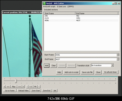

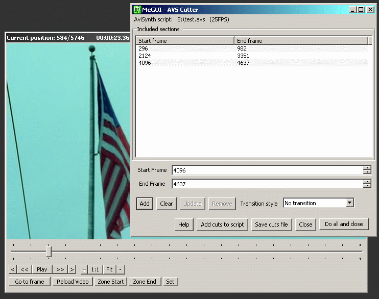

    "Continue to do it the long way" is the sort of thing I have trouble getting my head around. Fair enough if the short way requires an initial learning curve and it's not something you'll be doing often, but when the short way is as easy as it gets......
    Each to their own but the two methods are effectively the same except one requires you to add each Trim to a script manually while the other doesn't, although it'll let you type in every frame number manually if you'd prefer.
    Behind MeGUI's AVS Cutter is it's preview window (to make the image smaller). The same navigation and zone setting abilities as VirtualDub. Frame numbers and time stamps at the top. Easier resizing of the video preview. The AVS cutter contains three trims I've specified. Three or three hundred, once they're set it adds them all to the script with the click of a button. For me, discovering the AVS Cutter finally meant about the only reason for using VirtualDubMod again was to remux the occasional AVI.
    Don't worry, that'll be the extent of my nagging you about it.
