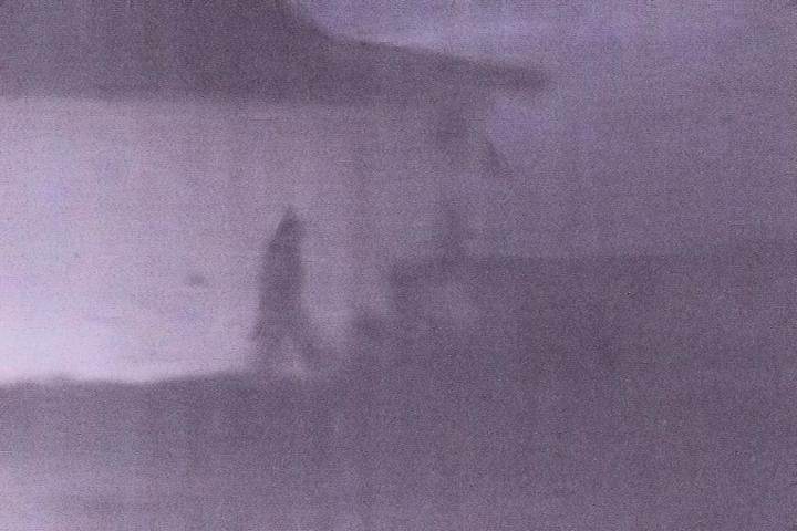

  5. Quick attempt:

  8. No just the first 50, I haven't downloaded the complete file yet. I am working in RGB mode because it's annoying fixing brightness, contrast, gamma and color with Aviscripts but the purple looks better than gray or brown IMO.
    OP, you saw the sample, is it good enough?

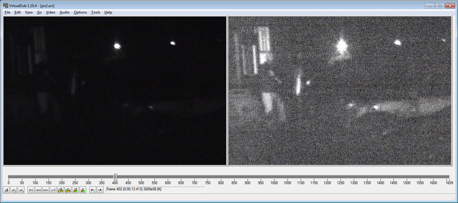

  10. HERE is your detail, sanlyn:
    Btw, neat video only works with RGB anyway so conversion will still happen.
  11. Banned
    New York, US
    That's what I mean. The "detail" is all noise. If you raise the darkest levels to RGb16 or brighter, all of that noise is about 40 or 50 RGB points ahead of it. Most of the detail, what there is of it, is spred over a spectrum only about 40 RGB value in extent. The bright lights are higher, of course.

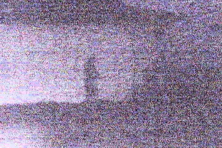

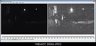

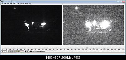

  13. Adjustments that bring out details in one shot totally blow them out in another. For example, adjustments to this frame to bring out details of the man's face:

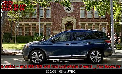

    Make it impossible identify the vehicle in this frame:
    So to do this properly is a lot more work than you think. You have to identify what details you want from which frame.
    Here's a brighter version that something of a compromise for all shots. I also applied deinterlacing and a heavy noise reduction filter so it's not as sharp as it could be.

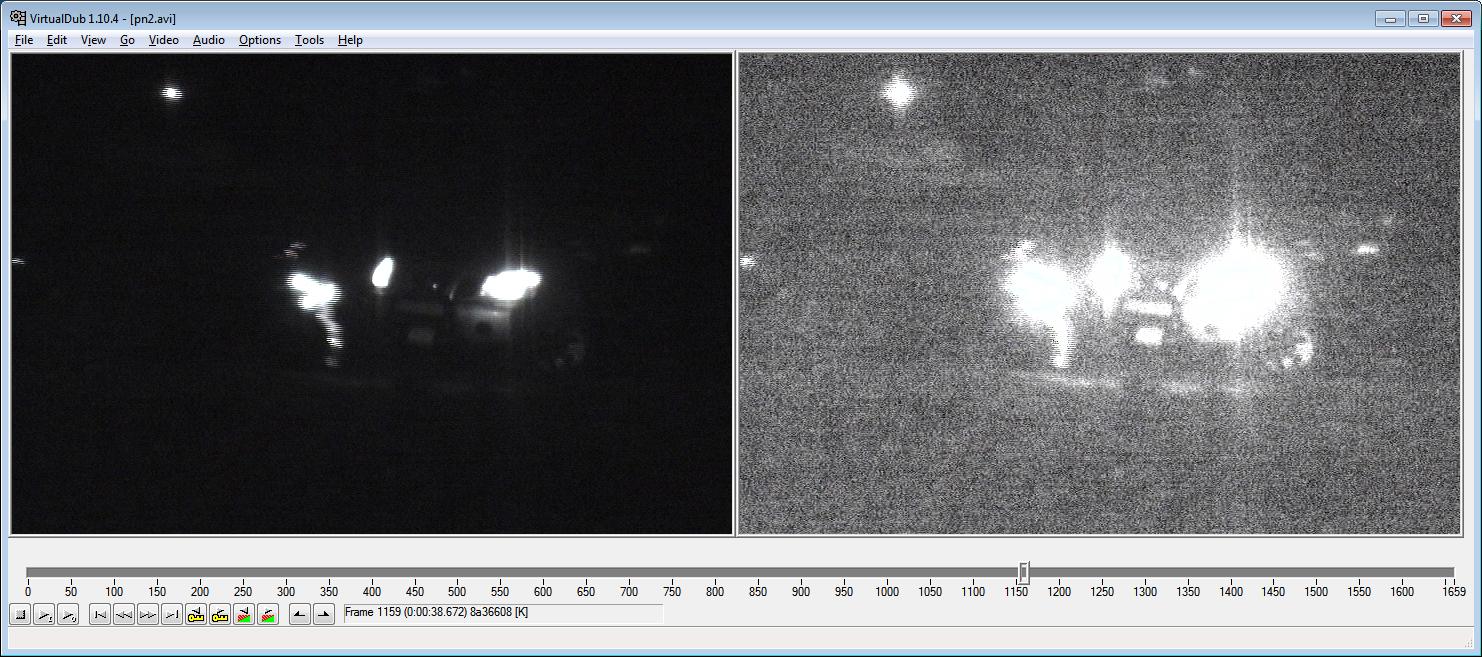

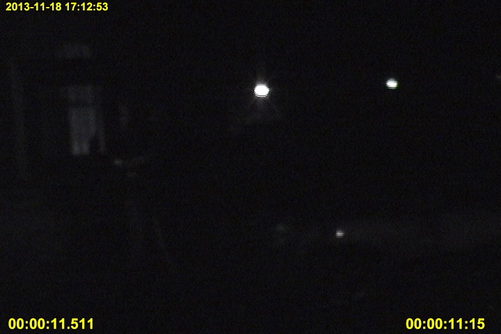

  19. RWH, messed around with brightness contrast and gamma while closely monitoring the histogram until it looked right. I made sure there were no peaks on a frame without the street lights. There are a few such tools that do this automatically for heavily-afflicted videos like these with a narrow contrast range. One of them is a histogram equalizer for Virtualdub with a dithering option to fill out the gaps in the histogram but I didn't use this for this video because it made everything look so bland and unnatural. It's useful for many videos but some need to be manually adjusted like this one.

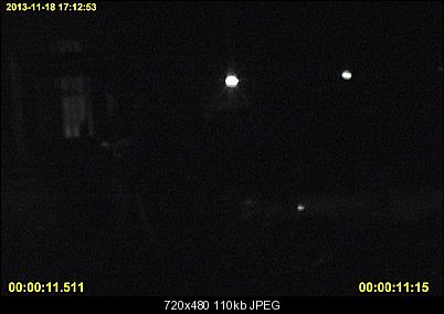

    Now it's my turn to ask a question, how did Maverick restore that timestamp? Is there metadata in the AVI or did you make that up?
  20. Originally Posted by Mephesto View Post
    He used AVIUtil , but I suspect the OP wants the original record date timestamp (the metadata in the AVI) , not the running time SMPTE timecode for the clip
    Use DVInfo() for the original timestamp, ShowSMPTE() for the running timecode in hh:mm: sec:frames, or ShowTime() for the hh:mm: sec:ms notation . Each has adjustments for x,y to adjust the position, fonts, sizes, colors etc...
    Top Left : DVInfo()
    Bottom Left: ShowTime()
    Bottom Right: ShowSMPTE()

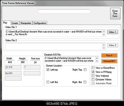

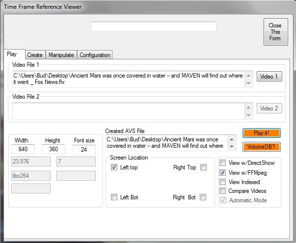

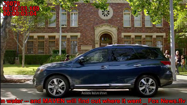

    If you want Video Information without DVInfo, just use these 4 lines from AVISynth: http://avisynth.org.ru/docs/english/corefilters/showframes.htm
    Subtitle("Ancient Mars was once covered in water -- and MAVEN will find out where it went _ Fox News.flv", font="Arial", size=24, text_color=$ff0000, align=3)
    ShowFrameNumber(scroll=true, x=10, y=27, font="Arial", size=24, text_color=$ff0000)
    ShowTime(x=72, y=44, font="Arial", size=24, text_color=$ff0000)
    ShowSMPTE(fps=23.976, x=68, y=61, font="Arial", size=24, text_color=$ff0000)
    Will display as shown:
Name:	ScreenHunter_44 Dec. 10 15.39.jpg
ID:	21879 Click image for larger version
Name:	ScreenHunter_44 Dec. 10 15.48.jpg
    Launcher is my program (Work in Progress) on the right for FLV repair and syncing.

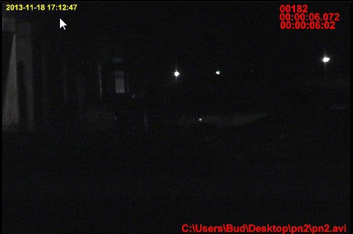

  27. What error message are you getting ?
    Did you call it like this:
    file = "S:\PATH\pn2.avi"
    AviSource(file)
    DVInfo(file, "rec_time")
  28. Oh my bad, no. I called it more like this:
    file=avisource("M:\pn2.avi")
    So I have to call the file twice basically?
  29. Member Budman1's Avatar
    Jul 2012
    NORTHWEST ILLINOIS, USA

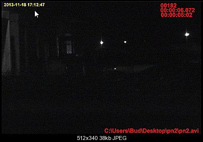

    Sorry for the misunderstanding... I reran the file and got an error on avisource also so tried it with directshowsource.
    Maybe that will work for you. The script I used also included the original so I could have the frame and time from
    start but it also showed the dvinfo as well. For some reason I have to load the plugin:
    loadPlugin("C:\Users\Bud\Desktop\Flash_Date_Time_S yncTabbed\bin\Debug\Dvinfo.dll")
    file = "C:\Users\Bud\Desktop\pn2\pn2.avi"
    directshowsource(file)
    Subtitle(file, font="Arial", size=24, text_color=$ff0000, align=3)
    ShowFrameNumber(scroll=true, x=576, y=27, font="Arial", size=24, text_color=$ff0000)
    ShowTime(x=638, y=44, font="Arial", size=24, text_color=$ff0000)
    ShowSMPTE(fps=29.97, x=634, y=61, font="Arial", size=24, text_color=$ff0000)
    Hope that works for you as well.
