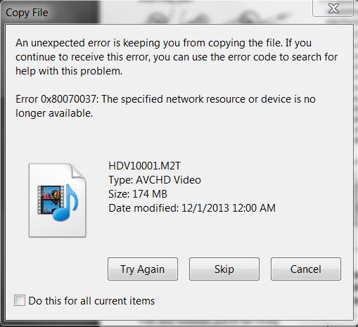

    just tried again and now finally got an error message....Error 0x80070037--the specified network device is no longer available
    see screen cap attached

  5. If you have another Firewire cable, try that. If it will connect USB, try that.
    If no joy, next step is to disassemble the enclosure, remove the drive, and connect it internally to a desktop. Alternately, you could try another, different enclosure but I would go for the direct connection first, if possible.

  10. Google your error code and Look up cougar point chipset flaw. It is a known intel problem. You may have a machine that is affected.
