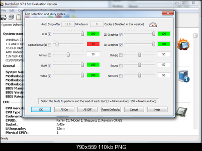

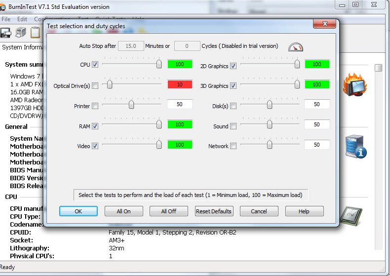

    Okay just did a burn test with everything necessary cranked to 100.
    See pic. And my computer did freeze up over a few minutes.
    So I'm going to do the test again just with the CPU active & at 100.
    It might very well be that my CPU is overheating.
    But I'll find out after this test.

    So from the burn test so far:
    I had everything (in the pic above) selected @ 100. And the computer froze, but the tower was still running.
    This time I had the CPU selected and everything else disabled and after 508 billion processes and maybe 2 - 3 minutes run time, my computer shut down completely, no freezing, no blue screen. Tower was off completely.
    So now I'm going to test my RAM on the burn test.
    Followed by the video/2D/3D ones.

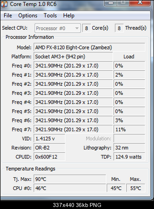

  24. Why aren't you doing the obvious test? Run CoreTemp while rendering. I suspect you're going to see temperatures in the 90's before the system locks up.
    I'm running a different CPU but I get CPU temps in the low 30's at idle, low 60's at full CPU load. And that's with the system optimized for quiet running, not max cooling.

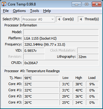

  28. Originally Posted by kyraejenkins View Post
    I downloaded the Core Temp, but when I click on the .exe file in my downloads it doesn't do anything
    Look in the System Tray. Do you see temps there? Make sure the Tray is enabled and items aren't hidden. I'm running a quad core system so there are four temps there:
    Right click on one and select Show/Hide to bring up a window:
    Be sure you're using the 64 bit version in 64 bit Windows: http://www.alcpu.com/CoreTemp/php/download.php?id=3
  29. Member
    Dec 2013
    Pennsylvania
    Okay, here is the reading. With nothing running.

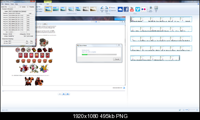

  30. Member
    Dec 2013
    Pennsylvania
    Okay here is a screenshot of Core Temp running while a video is rendering.
    It started out around 45○C and as you can see it hit 80○C.
    And if I'm correct the max it can go is 90○ so my guess is when the video renders to 30 - 35%.
    My CPU overheats (either because it is faulty or thermal paste is crap) which in turn causes the freeze.
    Yes?
