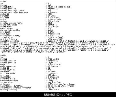

    I have a HDTV video that sized 2.15 GB, and here's the media info:
    I want to compress it to 700 mb - 1 gb with the same resolution (and not so lossy quality if it possible), and I've tried to encode it with handbrake, but it's failed (i dont know it's me or the setting). So if if i may ask, can you guys give me the handbrake preset/setting in order to get that size?
    Thanks in advance.
