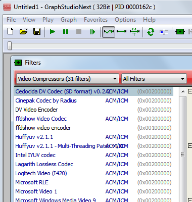

    is there any way to get the Cedocida DV Codec to work in a graphedit to capture with ?
  14. Originally Posted by vhelp View Post
    It should be listed in the Video Compressors section:

  15. Member vhelp's Avatar
    Mar 2001
    New York
    ah, how could i miss that. oh, because its not installed..dahh. i'm so off-balanced between this laptop and the desktop pc, thanks.

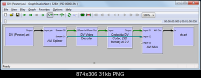

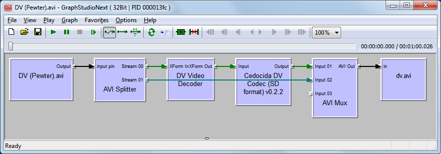

  20. I'm not on a computer with the the Elgato right now but using cedocida to re-compress an existing DV AVI gave a normal DV AVI file:
    That last filter is File Writer. Are you using Dump?
  21. Member vhelp's Avatar
    Mar 2001
    New York
    yes, was using the dump filter in those graphs. in previous attempts i had trouble with getting the file writer filter working on w7, so i searched google and found a dump.ax file and been using that ever since. maybe the fw filter will work in this case however. i'm at work too so can't test either devices, but luckly i have a cheap usb ati-750 with me (piece of junk) but can use that to test these filter scenarios here at work. i just hope i can get it to work w/out a "source" video to connect it to. my netbook is very limited. maybe the built-in cam can come in too, and test that somehow. i don't know. will try whatever i can with whatever i have. thanks for the suggestions!

  23. If you use Dump instead of File Writer you will not have an AVI file (regardless of the file extension) because the file will not have an AVI header.
    I used a file source because the computer I'm using doesn't have a capture device. I needed some source of audio and video to compress and mux so I used a file. Using cedocida to compress the video, followed by AVI Muxer and File Writer, should give the same result whether the source is a capture device or a decompressed file (CPU usage and timing differences aside).
