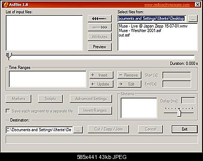

    Well, the fact is that I have already asfbin but It contains only the app for join/cut asf files. I don't found nothing about fixing or repairing videos
    I tried even to rename the wmv file to .asf and then repair it with asftools... but it remains the same
    Here's a screen:

    Just a question: where is the repairing tool of asfbin?? You can check my screen and see that I can only join or cut .asf files
    Months ago I heard something about a copy of .asfcut inside asfbin directory, I did that but nothing changed...

    The point is that I have the suspect that my asfbin is not complete. Look at the window, I can only drag&drop files on the left and then click the ''Cut/Copy//Join'' button that produces a 2/3 seconds of video, still I don't want to do that.
    And if I want to try asf multiplexer first I need to demultiplex video into elementary streams: How I can do that??
    I am a little bit confused
