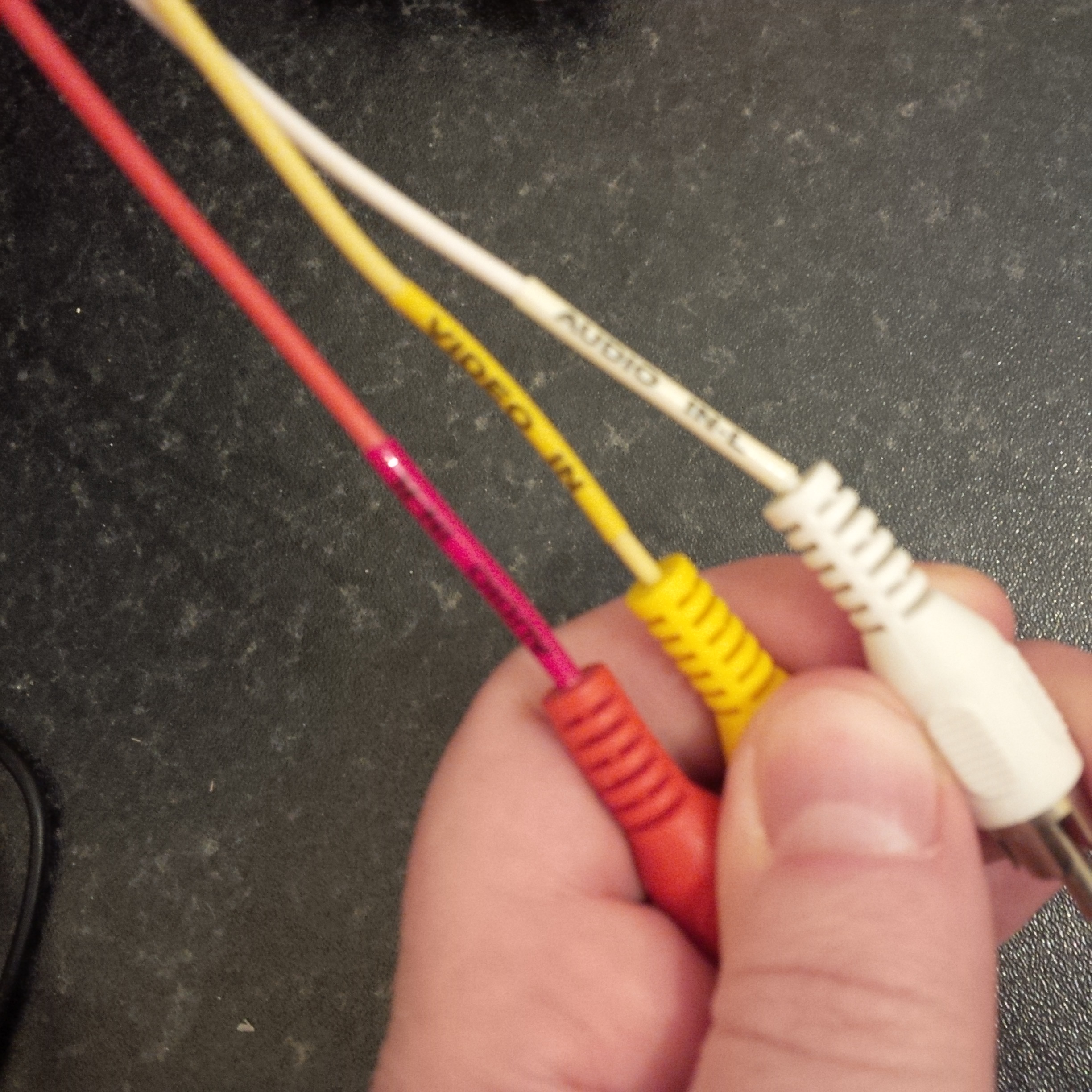

    When you say 'adapter' I presume you're referring to the scart-rca adaptor connected to the VCR? If so it doesn't explain how without any adapter, using three different scart-rca cables, the problem is the same - no signal over scart-RCA.
    Attached picture of the scart-rca that has 'In' marked on the RCA end. I have tested one that says 'out' too.

  12. Member DB83's Avatar
    Jul 2007
    On reflection (my cables have rested on the floor for over 16 years) are similarily marked. My adapter is fully wired so it has both 'in' and 'out' wires. Logic dictates that 'in' is the correct choice.
    Sorry, thought I was using female. When I checked (it was a long time ago) I am actually using RCA connectors for the longer cable run.
    The issue is clearly the sensitivity with the scart connection on the VCR. You may think it is correct but if it is not straight or a little loose........
