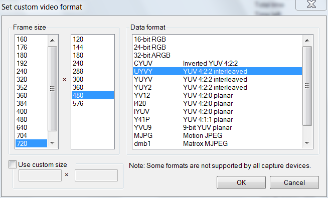

    Is this the setting that works?
    Did switching to composite cable get color back?

    Yes that is the only setting that seems to work. And last night I tried switching cables but it didn't change anything. I gave up last night because wifey was demanding my presence in front of the tv. Anyway, this morning I tried a completely new setup with a different tape etc. It is now showing in color. Who knows.................

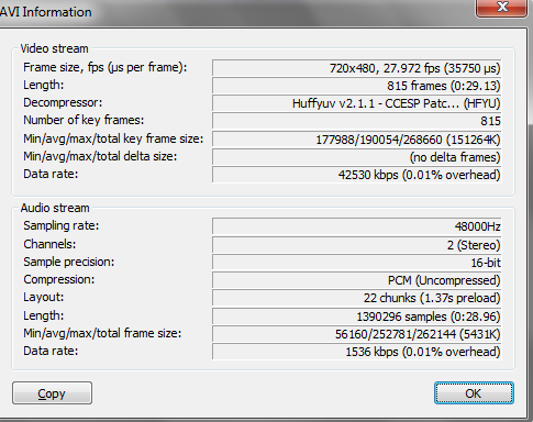

    That setting is perfect. Did you get the frame rate set properly?
    Can you save and upload just one frame? Just to check your setup.
    In VirtualDub the little buttons at the bottom. One of them will let you advance a frame at a time.
    Or post a screenshot of File > File Information.

    Here is a screen shot.

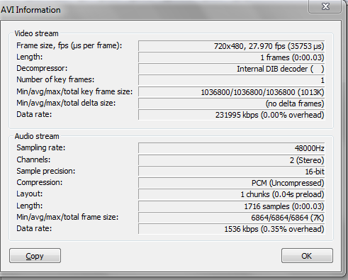

    Here is one single frame.
    Nov 2013
    Huntington Beach, Ca.
    Here is the info to go with that single frame.

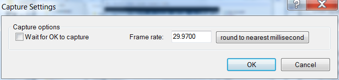

    Have to change framerate. In Capture Settings.

    pic

    I did go back and do that before I captured the single frame. I forgot to do it prior.

    If it's set to 29.97. You have to recapture from tape again. Then upload a frame of that capture. Getting close.

    Did you check the single frame I sent. It has the setting correct.

    Your info screenshot for the single frame still isn't correct. The right setting is "almost 30", not "almost 28", if that helps. Not sure how else it could be messed up other than mistyping.

    Ok, I see the problem. My old eyes thought they saw something they didn't. I'll correct it.
    Nov 2013

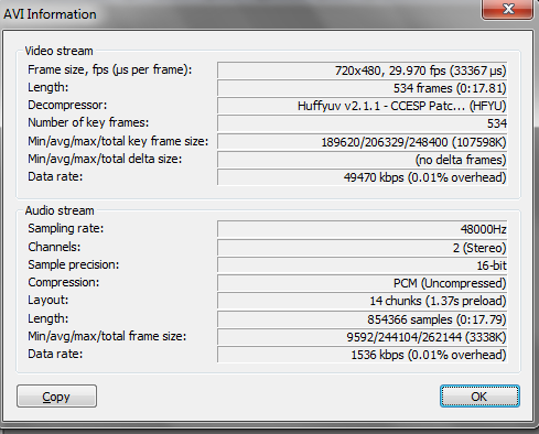

    I think I got it right this time. Sorry.
    R
    Nov 2013
    And here is the info.
  18. Member
    Nov 2013
    West Michigan
    Excellent. How about uploading a few seconds of this capture now. About 30 frames per second so maybe 150 frames.

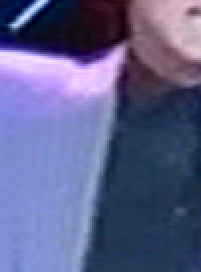

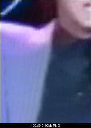

  24. Originally Posted by Oldretiredguy View Post
    Here is the clip I captured.
    It looks like the capture process is working now. Can you turn off the noise reduction circuit on the VCR? It's resulting in ghosting. A 4x point resize:
    Look at his lapel -- you can see ghosts of where the edge was in several previous fields (he's moving from left to right). That's caused by an over aggressive temporal noise reduction filter.

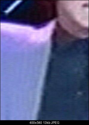

  26. I thought I remembered that some JVC decks link the noise reduction and TBC features. It looks like that's the case here. I guess you'll have to decide which is the lesser evil.
    You also probably want to keep the edge enhancement feature disabled. Those almost always cause ringing (halo) artifacts. I'm pretty sure it wasn't on in the capture in post 229. Here's a simulated example of an over sharpening halo:
    Notice how his lapel has a bright band at the edge, and his shirt has a dark band right next to it.
