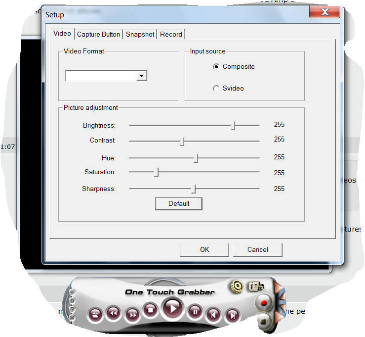

    The One Touch Grabber is sort of able to take over control of the internal driver settings in the background despite VirtualDub showing the video. I use this quirk to access the Proc Amp controls that are greyed out in your VirtualDub screenshot above.

    Ok, how did you make the red arrow? I've always wondered how folks do that in pictures etc.

    That's my custom arrow that can't be duplicated, not even by me. The pen tool on win7 snipping tool. Can't snip it though. Try.

    proc amp controls

    You have to switch your device to NTSC. I'll look into it.

    Open Grabber. Perss the yellow gear. Check the video tab. Video format should be NTSC_M.

    RWH, don't go away. I'm here and I'm messing with stuff so chime in with whatever you think of. It seems that it's just the two of us anyway. I'm having a great time. I did go into Grabber and the setting was correct for what you said. Right now, I'm copying my valuable tape over onto my computer with the settings that were suggested way back. I think it was sanlyn's suggestions. I've lost track of who said what. But anyway, it's copying right now but I only see a b/w in the monitor pane.

    OK. Stop capturing for now. The hawaii.avi was 720x576 PAL. With NTSC framerate.Better to try small (very) caps and samples til it's configured right. Stick with a non valuable tape for now.
    B/W no good.
    Let's try a sample of what you just captured.
