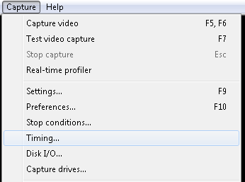

    Select File >Capture Avi Select Device and see if your device is listed.

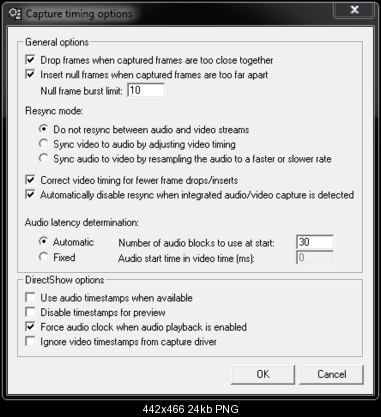

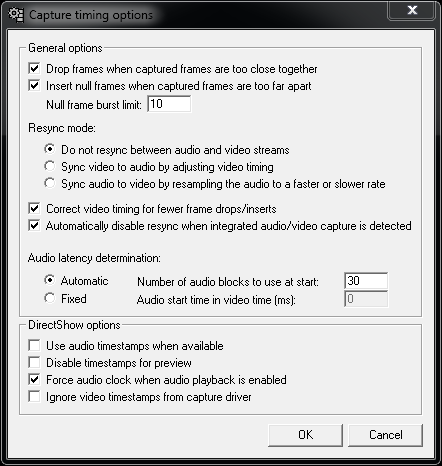

    I don't think 480 lines for Field Threshold is correct, as the tooltip mouseover says that interlaced processing is enabled for values above the threshold only. The default 288 is good (anything between 288-479, realistically).
    The correct frame rate is 30000/1001 which is 29.9700299700299700... (note the repeating pattern). VirtualDub's capture menu only lets you set a limited precision decimal for some reason, even though AVI files only use fractions internally.
    Ray, once you've gone through sanlyn's instructions, go to Video -> Capture filter. Click on the Video Proc Amp tab at the top of the window that pops up and please attach a screenshot of that tab. I haven't used the device on XP so I don't know whether the controls are accessible in that OS.
    The other settings to tick are the Timing options I mentioned before.
    Last edited by Brad; 6th Dec 2013 at 01:56. Reason: Add frame rate info, Timing settings
