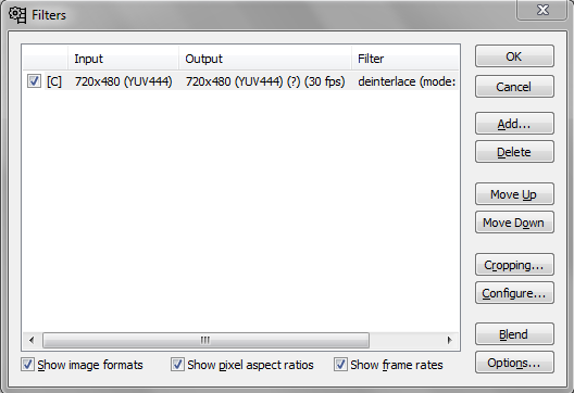

    Click OK here but note the YUV. If yours doesn't say that. Holler. Now when you zoom in on the Output Video Pane it should appear smoother.
    Here is what mine looks like.
    Nov 2013
    Huntington Beach, Ca.
    After posting the above I saw that you had the 3 boxes at the bottom checked. I had not done that. After doing it, I have the same as yours.Click image for larger version

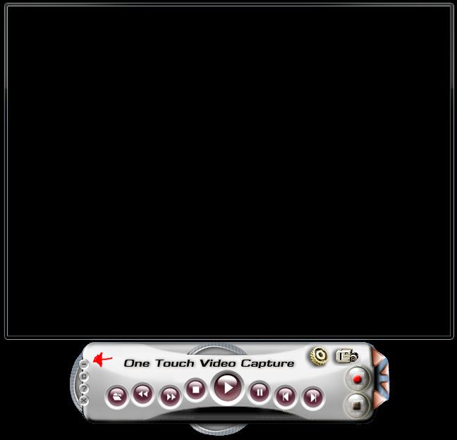

    Ok RWH, here is what I came up with. By the way, when I open Grabber and get the proc amp open, is there a way to get rid of the black screen in that program? I'm going to have to do a log in because it timed out.

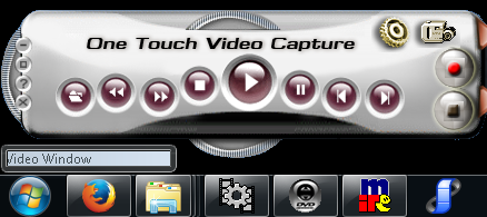

  19. Formerly 'vaporeon800' Brad's Avatar
    Apr 2001
    Vancouver, Canada

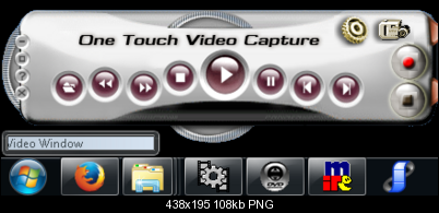

    To hide the black video screen:
    1. Hit the Minimize icon within the program.
    2. Restore the main panel by clicking on its icon on the Windows taskbar.
    Sometimes I have to maximize and minimize another program in the background to get this to work, and I'm not sure why it works at all. The black video window ends up minimized in the lower-left of the screen with the caption "Video Window" while the main panel lets you hit the gear icon.

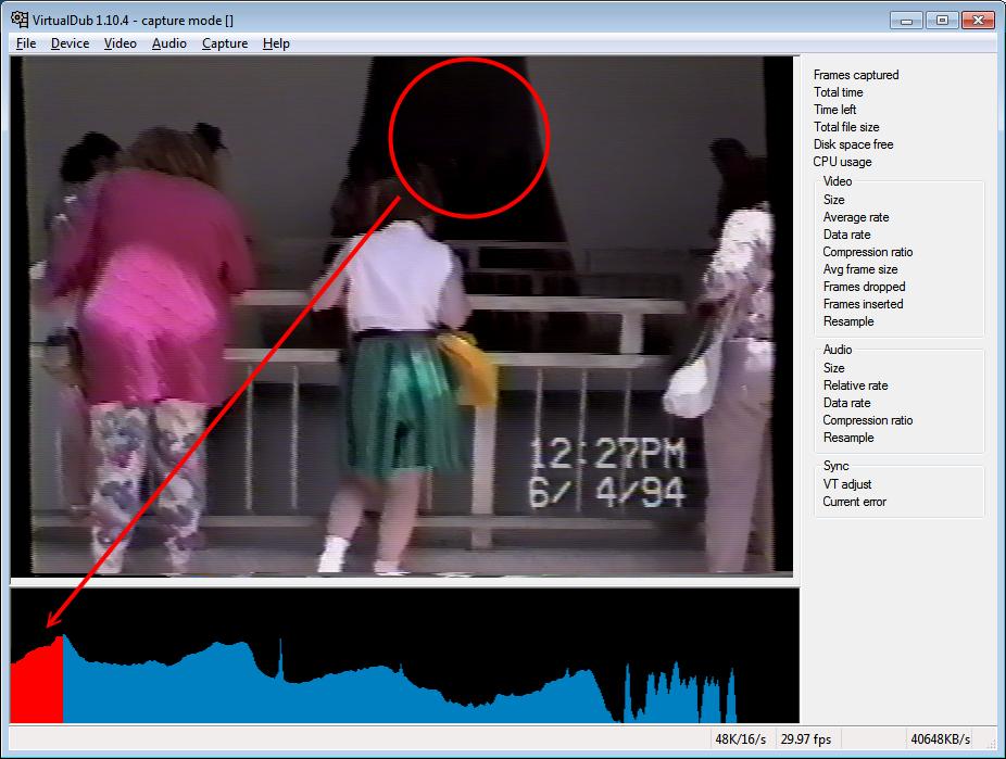

  20. Originally Posted by Oldretiredguy View Post
    The file got too big and now I'm too frustrated to start over.

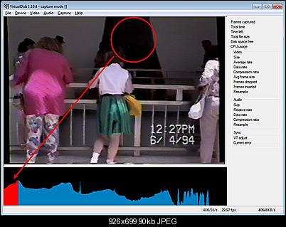

    You don't need to capture while you're making the adjustments. You can see the proc amp adjustments while previewing. Start VirtualDub, go to capture mode, select Video -> Histogram and Video -> Preview. You should see the incoming video signal with a histogram below. You can use the proc amp adjustments in VirtualDub (probably in Video -> Capture Filter or Video -> Crossbar) but that doesn't give you a live view. Ie, you can't see the results of the adjustments while making them, only after you close the proc amp window and return to previewing.
    Assuming One Touch Grabber works as others have said, start it up. (If its big black window is in the way move it to the left so that most of its window is off the screen, leaving just the "gear" button and other controls at the right edge visible.) Press the "gear" button to bring up the proc amp. Take note of the default values in case you want to go back to them (the Default button can also reset all the settings). Move the Brightness and Contrast sliders around to see what effect they have on the picture and histogram. In a shot with a lot of bright and dark areas you should see the histogram fill most of its window but should not extend into the red areas to the left and right. Here's a simulation of what you will see:
    The circled black area (and the black borders and a few other dark patches) are responsible for the red area in the histogram. You don't want to see a lot of red at either end (darks at the left, brights at the right) of the histogram. Adjust the proc amp to get rid of the red. Since you probably don't want to "ride the pot" while capturing so go through the tape and find shots with the brightest and darkest elements. Make compromise adjustments to the proc amp so that the histogram hardly ever goes into the red. Then capture your video. Of course, not all shots will have full black and full brights so the histogram will not always extend fully to the left or right.

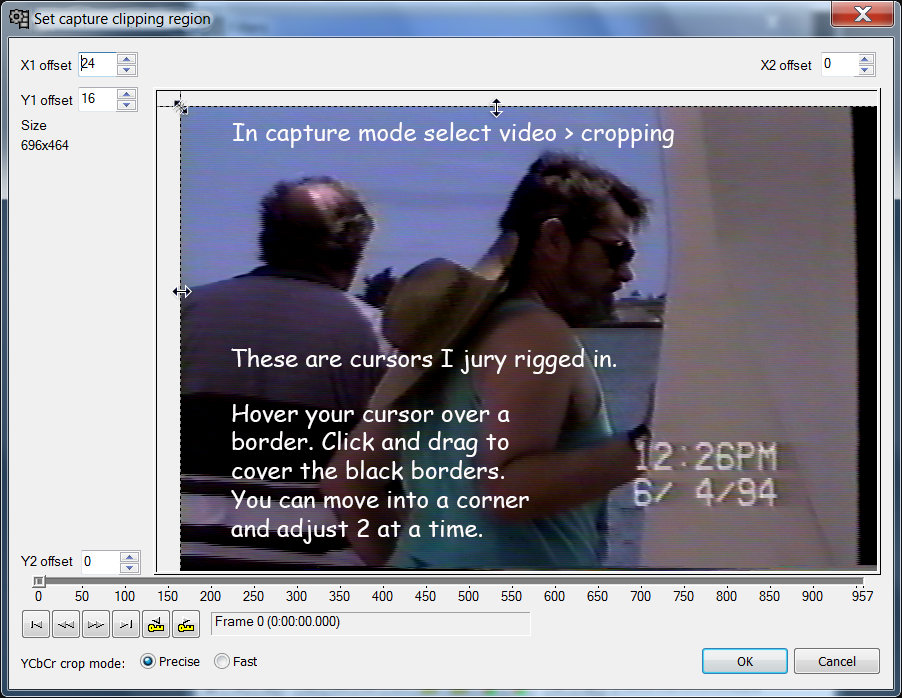

    I think you should do this to hide the black borders for testing, monitoring the histogram.
    Gee I don't know if you should capture with the borders cropped or not
Name:	capture region clipping.png
    Nope; especially not if the destination is DVD.
