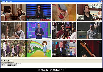

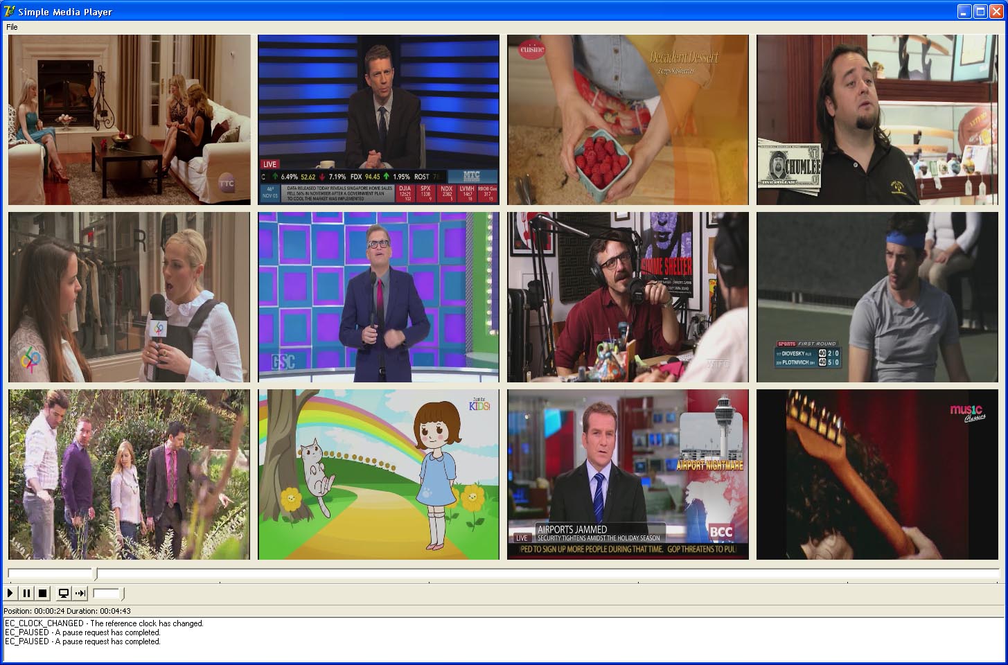

  20. I have news.
    As said before, I wrote a small program to load the videos and show them in a mosaic. This is the first step toward to the feature to "change channels".
    I'm using DSPack components, which uses DirectShow and Direct9 libraries.
    As seen on picture, 12 videos were loaded. I noticed some lag from 4th video ahead. The last one, 12th, were very lagged.
    I checked the Task Manager and saw that the program is using only 50-55% of the CPU, not 100% as I suspected. CPU is working with idleness. So, what the problem? I don't think this is the video card. I have a nVidia GeForce 8600GT.
    When the videos are running, the system tray shows too many ffdshow icons, as seen on picture below.
    I'm planning to turn off visible property for all other videos, when seeing a video by time, when implementing feature "change channels", to alleviate the system. But when in mosaic layout, it's not possible.
    What do you suggest to fix the lag among videos?
    Thank you.
